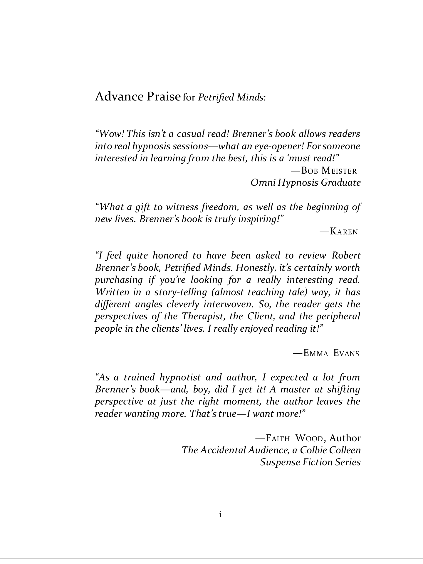

I bought a book today that seems to be an Indesign export. Every word has its own formatting. On my ereader there are huge margins, so it's not readable.
I have tried changing/removing stuff, but haven't been able to make anything helpful.
Ideas?

Looking at the code, what you have is a fixed layout epub3 file. You need an application or ereader device that will handle that format. Try renaming it from filename.epub to filename.fxl.kepub.epub and see how it looks on your Forma (the fxl.kepub.epub extension tells your Kobo ereader it's a fixed layout epub3). Check the Kobo Epub-spec at Github under the Sideloading for Testing Purposes for more information.

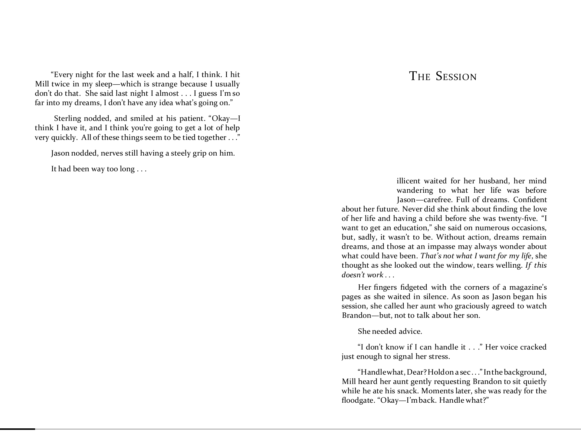

That's because it is a fixed layout ebook. The only change you can make is using the zoom option and that is pretty much useless for this ebook. I was also noticing that the dropcaps (another idea that should never be used in an ebook) are not done properly.
Other items: the ebook does not have a cover image as such. When I imported it into calibre, the title was "Petrified Minds TRIPLE KINDLE FINAL.mobi" and the author was unknown. The xhtml navigation document has a PageList but no ToC entries which is yet another standard violation. It looks as if a goodly chunk of the stylesheet is missing (Indented-Paragraph, Drop-Cap, Chapter-Title, etc., etc.).
Somewhat interestingly, from the content.opf, this epub is intended to be read in landscape with the pages carefully labelled as left/right and the Apple metadata to allow using embedded fonts is present:
    <meta property="ibooks:specified-fonts">true</meta>
    <meta property="rendition:layout">pre-paginated</meta>
    <meta property="rendition:orientation">landscape</meta>
    <meta property="rendition:spread">both</meta>
    <itemref idref="Petrified_Minds_TRIPLE_KINDLE_FINAL.mobi-1" properties="page-spread-right"/>
    <itemref idref="Petrified_Minds_TRIPLE_KINDLE_FINAL.mobi-2" properties="page-spread-right"/>
    <itemref idref="Petrified_Minds_TRIPLE_KINDLE_FINAL.mobi-3" properties="page-spread-left"/>
    <itemref idref="Petrified_Minds_TRIPLE_KINDLE_FINAL.mobi-4" properties="page-spread-right"/>
    <itemref idref="Petrified_Minds_TRIPLE_KINDLE_FINAL.mobi-5" properties="page-spread-left"/>
    <itemref idref="Petrified_Minds_TRIPLE_KINDLE_FINAL.mobi-6" properties="page-spread-right"/>
Overall, the kindest thing I can say about the structure of the epub is that it's an abomination. I've attached some screenshots from my Forma. Likely the same crap you've already seen.

Yep, like DNSB said, that's a Fixed Layout EPUB.
The way you can tell is InDesign wraps every single individual word in a <span> and absolutely positions it:
<p class="Drop-Cap ParaOverride-1"><span class="CharOverride-14" id="_idTextSpan41408" style="position:absolute;top:2537.09px;left:-34.4px;">“</span><span class="CharOverride-3" id="_idTextSpan41409" style="position:absolute;top:2589.14px;left:326.11px;">I </span><span class="CharOverride-3" id="_idTextSpan41410" style="position:absolute;top:2589.14px;left:515.94px;letter-spacing:0.87px;">want </span><span class="CharOverride-3" id="_idTextSpan41411" style="position:absolute;top:2589.14px;left:1107.67px;letter-spacing:-1.22px;">you </span><span class="CharOverride-3" id="_idTextSpan41412" style="position:absolute;top:2589.14px;left:1567.94px;letter-spacing:-0.62px;">to </span><span class="CharOverride-3" id="_idTextSpan41413" style="position:absolute;top:2589.14px;left:1877.72px;letter-spacing:1.83px;">imagine </span><span class="CharOverride-3" id="_idTextSpan41414" style="position:absolute;top:2589.14px;left:2773.35px;letter-spacing:-0.23px;">your </span><span class="CharOverride-3" id="_idTextSpan41415" style="position:absolute;top:2589.14px;left:3321.68px;text-rendering:optimizeLegibility;letter-spacing:0.73px;">reflection </span> [...]</p>
Compare to:
<p class="Drop-Cap ParaOverride-1">“I want you to imagine your reflection [...]</p>
And as you noticed, only zooming + panning/scanning, no changing fonts, and missing all the other fantastic advantages a true ebook brings!
Bah, that's another problem with InDesign's fixed layout EPUBs, they export code that only works in Apple's iBooks.
And I have no idea how that passed Kobo's Quality Control in the first place.
Woof.
And the book looks like it's a basic Fiction book, just pure text. There's absolutely zero reason for that to be a fixed-format book.
