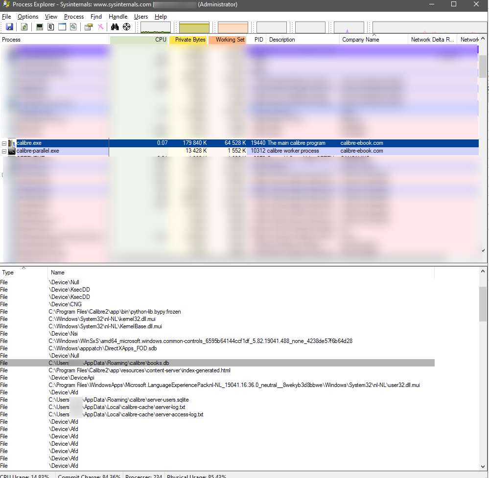

I wonder about this... (see screenshot)

Old 02-04-2021, 06:33 AM   #9
Posts: 46,031
Karma: 29579868
it will have been created by some third party plugin you are using run calibre as
calibre --ignore-plugins

Problem solved. Books.db turned out to be the calibre.db after all. It was set a long time ago with CALIBRE_OVERRIDE_DATABASE_PATH. I removed the override and copied and renamed books.db to the NAS-folder. Now I can use Calibre on both PC's, even at the same time. With the Calibre webclient I can only see book title and author. All other meta seems hidden. Then I have to download it, while I want to use the book on its location on the NAS so highlights etc are preserved. Unfortunately this seems not possible while using FBReader on my phone.
