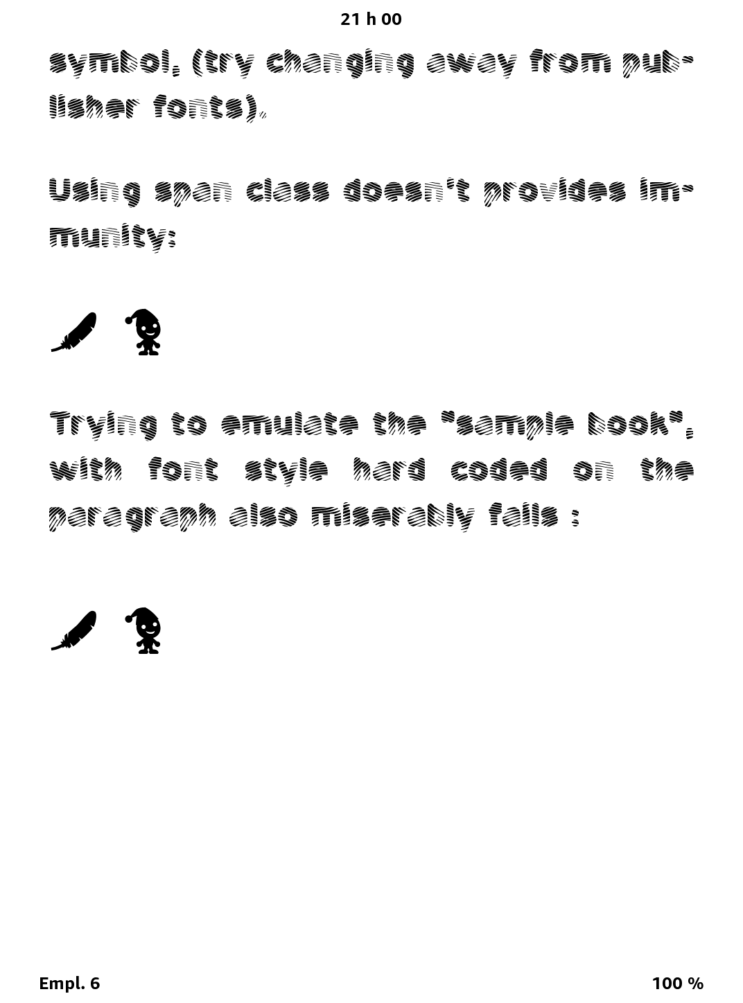

I took a look at the free sample for that book. The chapters from the point of view of Joyce (chapters 1 and 4 in the sample) have the font hard coded. It looks like a an intentional choice made by the publisher....
I never could achieve locking fonts. By curiosity, I unpacked the sample and looked for the enabling statements ...to no avail.
Would you please point at the method?
[EDIT 12:43] Perhaps this from the sample opf? Then how to code it for Kindlegen?
<meta name="override-kindle-fonts" content="false" />
As far as I know you cannot lock in a publisher font in KF8 (azw3) format. It only works for KFX.
I converted your "fontlocked" book to KFX (after fixing some problems with the OPF) and it works as desired. The special symbols are shown no matter what font the user selects.
(The file is attached.)
Thank you. KFX only, nice to know. I too (but only after adding <meta name="override-kindle-fonts" content="false" /> to my opf) and converting to KFX got the desired behaviour:
