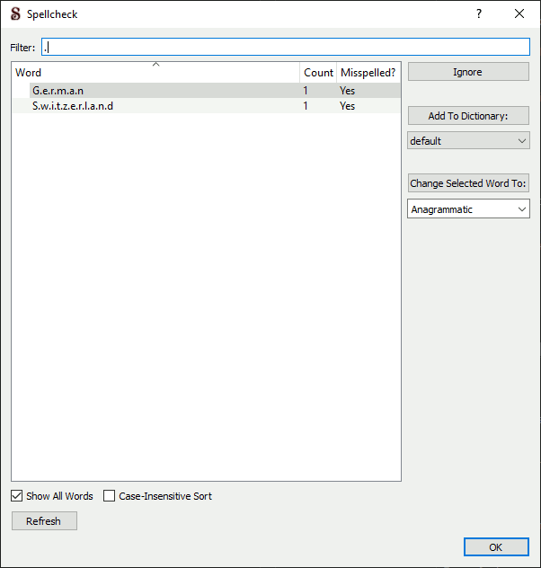

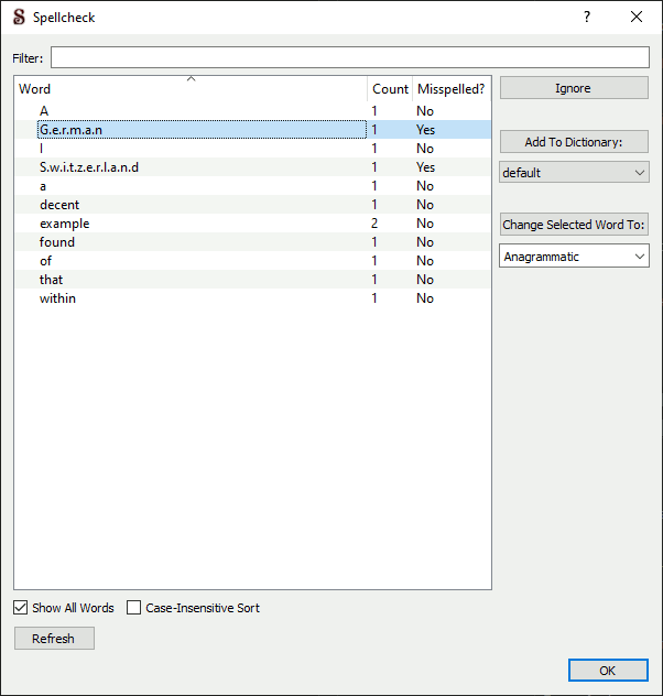

And as usual, I've been pondering on how to get Spellcheck Lists to help you solve this issue more efficiently.
Instead of using a '+' or '¬', it might be better to use a period:
<p>A decent example of S.w.i.t.z.e.r.l.a.n.d that I found within a G.e.r.m.a.n example.</p>
This allows you to spot all of them easily in Sigil's or Calibre's Spellcheck Lists:
ID:	185083 Click image for larger version
All merged words right there in a simple list.
Although the period will bring a few other minor issues (like "a.m." or "p.m."), but the amount of time you'll save is massive.
