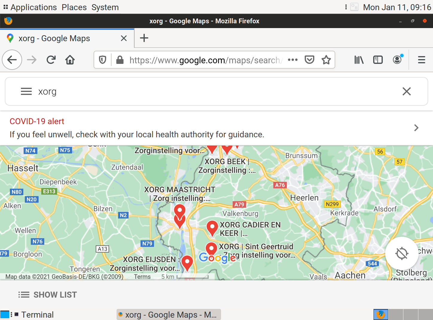

Hi,
As some of you probably saw in the Developers' corner, I started to make a preinstalled image of Alpine Linux with Xorg and Firefox in it to install it on a Kobo effortlessly.
I'm now here with a first release candidate of KoBox. It is *not* perfect, even the install process could not work (though it won't brick your Kobo, I'm fairly sure).
Here's a video: https://www.youtube.com/watch?v=jICSx2SxzNM
You can find it here: https://sourceforge.net/projects/xorg-kobox/
Direct download: https://sourceforge.net/projects/xor...x.txz/download
The file is approx. 500 MB in size, so depending on the speed of your connection it could take a while to download.
What.... what is this file......? If you didn't recognize the .txz extension, to put things simple, it's essentially similar to .zip files, only compressed (much) more. What you'll want to do is to install 7-Zip and that will uncompress it for you.
How do I install this? The process is similar to NiLuJe's one-click packages for Plato/KOReader. You'll have to decompress the archive in the root of the KOBOeReader partition (after plugging in your Kobo, of course), not anywhere else. Then, be *sure* to properly eject it (if it says "can't eject the device, *wait*) and it should work after "updating" a little.
Caution: This being a RC-1, it sure comes with a few caveats that I'd like to have had cleared off before uploading this to SourceForge on my 150KB/s upload connection That being said:
If you already uncompressed the archive in KOBOeReader, you're not lost. Really, you only have to uncompress whats inside the "kobox" folder in the archive.
At the end you shouldn't have any "kobox" folder in the root of your KOBOeReader partition. Just new icons and a new .adds folder (if you didn't install anything else before, like Plato or KOReader).
How to launch this? Normally, if all is correct and you extracted the contents of the kobox folder in your KOBOeReader partitions, you should see a thing called "NickelMenu" in the bottom-right of your Kobo's home screen. (BTW, thanks @geek1011). Ensure you're connected on Wi-Fi, then tap on it, and you should see something called "KoBox". Take a deep breath and click on it. Things should start to show on the screen. If you make it to the tiles wallpaper, you can already be pretty sure that it will work. Touch may not work right away. If the screen orientation is bad or touch is working strangely, do this on an SSH session to your Kobo (this will change in the future):
echo 1 > /sys/class/graphics/fb0/rotate
If you tap on the screen afterwards, things should work properly. *However*, your input device may not be what I programmed the script to listen for (/dev/input1). If so, please report it below. I will tell you how to get it working, if I can.
I can't shutdown!
Open gnome-terminal (Applications/System Tools/Terminal) and type:
sync
poweroff
It's *very important* to do this, and not shut down your Kobo forcing the power button. This may lead to a corruption of certain files (namely /var/log/Xorg.0.log) or folders that can lead KoBox to fail launching.
Will this erase/brick my Kobo?
99% sure not. Basically, the Xorg server runs in a chroot on a disk image. If you don't understand what I just said, well you could think of it as a very secure and containerized environment.
*But* I can't guarantee anything and I strongly recommend that you make a backup of your books before you try anything of this. And if it breaks, I'm not to be considered responsible of this situation.
Spec sheet/miscellanous
Tested models
Kobo Libra H2O, Kobo Glo HD
Programs included (not exhaustive): firefox, geany, xterm, uxterm, gnome-terminal, mate-panel, x11vnc, feh, idle3.8, python3, obconf, pcmanfm, nautilus, vim, nano, htop, onboard
Installable via apk (package manager), including, but not limited to: gcc, g++, clang, qmake, falkon, midori, epiphany
You'll *want* to install another web browser. Although Firefox is OK for short-term sessions, it has a preponderance to crash when used for a longer period of time. I recommend Falkon or Midori, or you can build Luakit from source if you're brave enough.
Example:
apk add falkon
to install Falkon
Things forgotten/to fix/to add/improve
- Fonts (Noto Sans Mono in Firefox is strange)
- Onboard keyboard
- Shutdown button
- Multitouch input
Credits
Thanks @NiLuJe, @geek1011 for NickelMenu, @Elektron for the name (@hobnail too, finally I decided to take KoBox instead of Xobo, but good one indeed!), schuhumi (from GitHub) who originally developed fbink-xdamage
