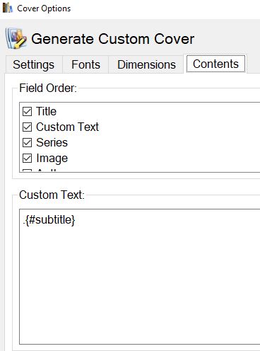

Question Subtitle Splitting / Handling
I skimmed this thread and didn't see anything about Subtitles so if this has been asked I apologize.
Is there a way to have the generated cover smartly handle subtitles?
For example, if the book title is "My Doctoral Thesis: A short description of the research" I'd either want the cover to only have "My Doctoral Thesis" OR have that and then "A short description of the research" in a smaller font underneath.
In theory, having a "Separate Subtitles on: [__]" option would be the key change to the UI. (I think?)
For whatever it is worth, this might also help people that have put a series in the title field. Where I'd be using ":" they might use "-" instead.
Thanks in advance!
mneimeyer is offline   Reply With Quote
Old 12-12-2020, 08:34 PM   #702
Posts: 31,536
Karma: 62543878
You can place a custom field (eg {#subtilles}

So often the subtitle is part of the subtitle, and not something I'd want to change necessarily. It certainly would be nice to be able to put in a regex to extract the subtitle automatically before making the cover!
