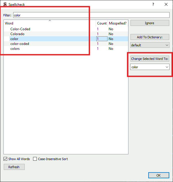

Alternate Method
Your best bet will probably be Sigil's fantastic Tools > Spellcheck > Spellcheck.
This allows you to search through all words in a book in an easy-to-read list.
In there, you're also able to select a word, then "Change Selected Word to":

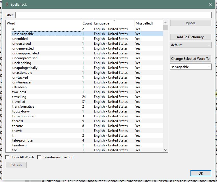

I have tried the Spellcheck option as suggested by Tex2002ans and I get the following result -
https://www.mobileread.com/forums/at...1&d=1610198353
The language has defaulted to US English (the book was published in the US) so it is now picking up words that I have already corrected to UK spelling as being misspelled.
I have tried clicking on the Language column to see if I can change it to UK English so that it spellchecks against the default UK dictionary, but there appears to no way to do that.
What am I missing?

Sorry Becky, I'm not sure I understand you.
The book was written with US spellings and all I want to do is spellcheck it against the default UK dictionary.
The spellcheck pop-up has spotted that it's a US book -as the language column has been set to that - so it's telling me that UK spellings are wrong.
All it appears to be doing at the moment is highlight words that it considers are misspelt in American and NOT those that are misspelt in UK English because it's checking against a US dictionary - which I don't have set as my default.
Oh, and the language in the opf is - <dc:language>en</dc:language>

In Sigil Preferences: set your Primary Spellcheck dictionary to English-Great Britain.
Then try spellchecking again. If there are still issues, then look for lang or xml:lang attributes set to en-US someplace in the html.

Thanks Kevin,
My default dictionary was already set to English - Great Britain, but your second suggestion was the problem as the headers all had lang="en-US" xml:lang="en-US in them.
I have removed the -US from them and Spellcheck now works as it should and only picks up UK misspelled words.
I will remember to look for that in the future.
