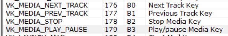

My Bose QC35 generates MediaPlayPause but as far as I can tell Calibre hears "Media Play". I'm on Windows 10.

sorry no clue, calibre doesnt interpret key events, that's done bg Qt WebEngine, calibre can only react to the actual events it receives.
