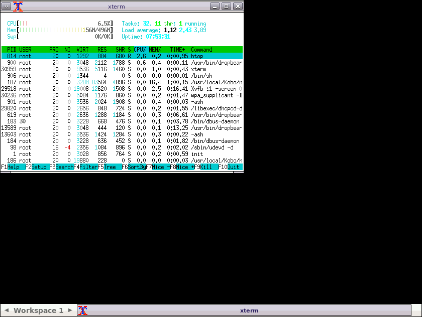

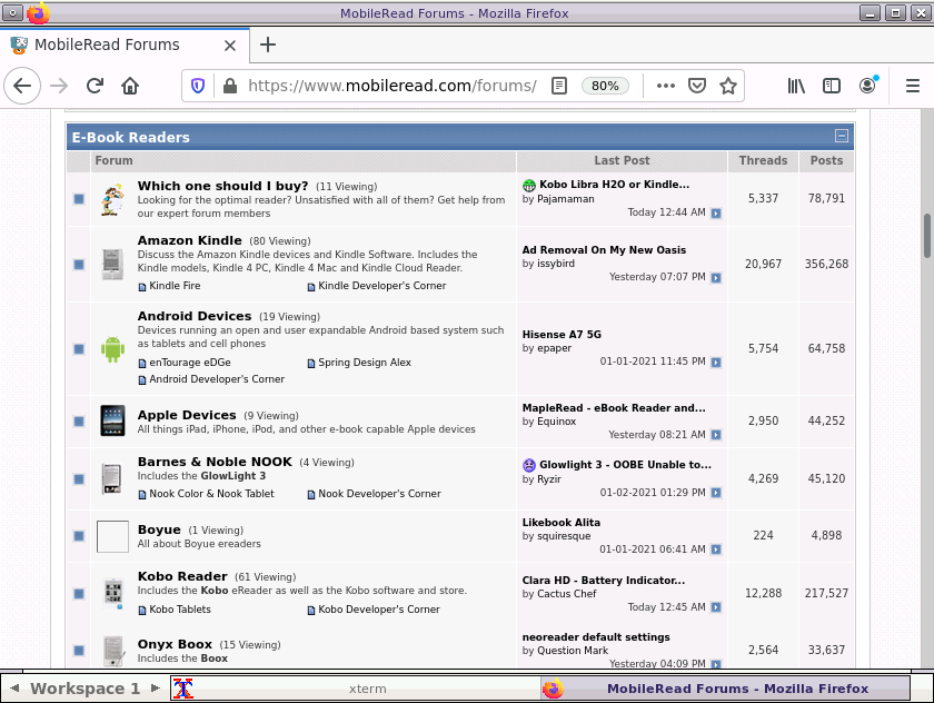

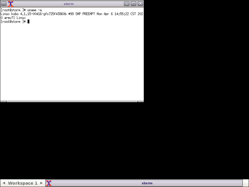

Talking X IS WORKING !!!!!!!!!!!
@hobnail Your dream has (nearly) come true!
Well this was quite long. I'll post some screenshots here as well as in the main post, but I'll explain it all in detail tomorrow. It's nearly 1 A.M. here and I really need some sleep.
So what I did (yes I know, it's not the best technique) was to use Xvfb (fake video driver) to create a "fake" display (:1) and then capture a screenshot of the display with ImageMagick. After that, displaying it continuously with FBInk. No touch for now, but you can input things with xdotool on the SSH client.
It runs Fluxbox and I've installed XTerm and Firefox, worked quite well.
I'll continue that tomorrow !

Posted instructions. Not the best technique but since I'm a total noob in C/C++/C# (but I know Python, though), I can't do much. I tried some things with /dev/fb0 but with no such luck. If someone wants to contribute, it would be very welcome and we could try to have full, real Xorg experience on our Kobos (still, I think it's possible to run that in standalone mode with Inkvt in the background and the image resolution set to low so we can see the keyboard... + a couple of shell scripts)
Please try it and report what it did for you, if you can (& want, of course!)
