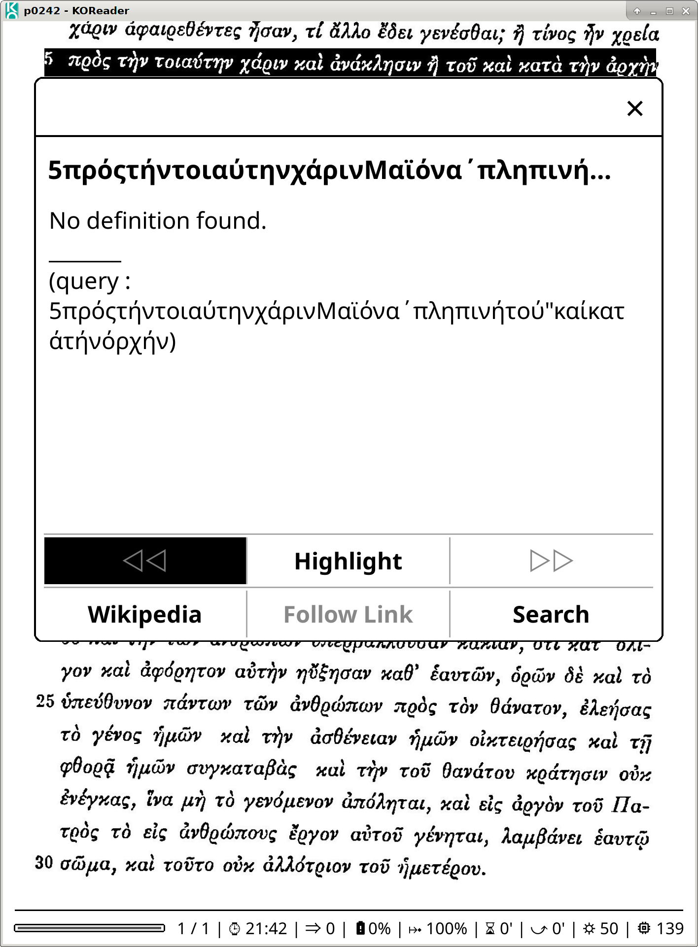

It works for me — more or less. The OCR isn't great at spaces in italic.

From the screenshot you sent I conclude that the breathings (᾿ ῾), the circumflex (῀) and the grave accent (`) are not recognized... and some letters
Can this problem be solved?
It's probably much less of a problem in non-italic text, but unless you have a slightly higher DPI original document not really. A newer version of Tesseract might also do slightly better.

Actually the problem isn't with the italics but with Greek (even Modern Greek). When I highlight a text with upright letters, both Greek and English, in the popup dictionary window there are not spaces among the Greek words, but only among the English ones.
It's a pity I can't take a screenshot of this...
