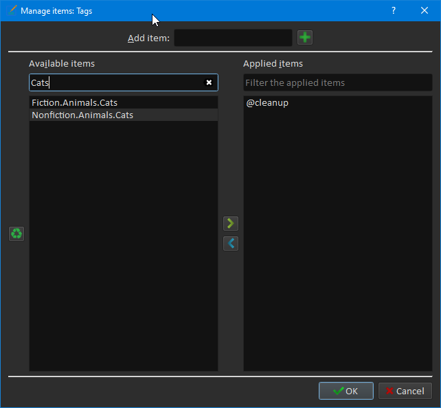

Question: How would I write a module to open up the item editor for the tags directly?
Attachment 184161
What exactly are you trying to achieve?

I can already edit the tags themselves in the book list. I'd like to make a keyboard shortcut to this window without the step click of "Open tags prompt > click button."
Name:	2020-12-21 13_50_57-Manage items_ Tags.png

Here is the action you asked for. It is mostly a copy/paste from single field edit.
from PyQt5.Qt import (QApplication, Qt, QWidget, QVBoxLayout, QHBoxLayout,
                      QGroupBox, QComboBox, QPushButton, QRadioButton)
from calibre.gui2.dialogs.tag_editor import TagEditor
from calibre_plugins.action_chains.actions.base import ChainAction
from calibre_plugins.action_chains.templates import check_template, TEMPLATE_ERROR
from calibre_plugins.action_chains.templates.dialogs import TemplateBox
def get_possible_cols(db):
    fm = db.field_metadata.custom_field_metadata()
    cols = [ col for col, cmeta in fm.items() if cmeta['is_multiple'] ]
    cols = [ col for col in cols if fm[col]['datatype'] not in ['composite',None] ]
    cols.insert(0, 'tags')
    return cols
class ItemEditorConfig(QWidget):
    def __init__(self, plugin_action):
        QWidget.__init__(self)
        self.plugin_action = plugin_action
        self.gui = plugin_action.gui
        self.db = self.gui.current_db
        self.possible_cols = self.get_possible_cols()
        self.template = ''
        self._init_controls()
    def _init_controls(self):
        self.blockSignals(True)
        l = self.l = QVBoxLayout()
        self.setLayout(l)
        col_box = QGroupBox(_('Choose column:'))
        l.addWidget(col_box)
        col_box_layout = QVBoxLayout()
        col_box.setLayout(col_box_layout)
        name_layout = QHBoxLayout()
        col_box_layout.addLayout(name_layout)
        name_opt = self.name_opt = QRadioButton(_('By column name'))
        name_layout.addWidget(name_opt)
        name_opt.setChecked(True)
        self.col_combobox = QComboBox()
        self.col_combobox.addItems(self.possible_cols)
        self.col_combobox.setCurrentText('tags')
        name_layout.addWidget(self.col_combobox)
        highlighted_opt = self.highlighted_opt = QRadioButton(_('Currently highlighted column'))
        col_box_layout.addWidget(highlighted_opt)
        template_layout = QHBoxLayout()
        col_box_layout.addLayout(template_layout)
        template_opt = self.template_opt = QRadioButton(_('By template'))
        template_layout.addWidget(template_opt)
        self.template_button = QPushButton(_('Add template'))
        self.template_button.clicked.connect(self._on_template_button_clicked)
        template_layout.addWidget(self.template_button)
        l.addStretch(1)
        self.setMinimumSize(400,200)
        self.blockSignals(False)
    def get_possible_cols(self):
        return get_possible_cols(self.db)
    def _on_template_button_clicked(self):
        d = TemplateBox(self, self.plugin_action, template_text=self.template)
        if d.exec_() == d.Accepted:
            self.template = d.template
            self.template_button.setText(_('Edit template'))
    def load_settings(self, settings):
        if settings:
            if settings['col_opt'] == 'name':
                self.name_opt.setChecked(True)
                self.col_combobox.setCurrentText(settings['col_name'])
            elif settings['col_opt'] == 'highlighted':
                self.highlighted_opt.setChecked(True)
            elif settings['col_opt'] == 'template':
                self.template_opt.setChecked(True)
                self.template = settings['template']
                if self.template:
                    self.template_button.setText('Edit template')
    def save_settings(self):
        settings = {}
        if self.name_opt.isChecked():
            settings['col_opt'] = 'name'
            settings['col_name'] = self.col_combobox.currentText()
        elif self.highlighted_opt.isChecked():
            settings['col_opt'] = 'highlighted'
        else:
            settings['col_opt'] = 'template'
            settings['template'] = self.template
        return settings
class ItemEditorAction(ChainAction):
    name = 'Item Editor'
    def run(self, gui, settings, chain):
        db = gui.current_db
        rows = gui.current_view().selectionModel().selectedRows()
        book_ids = [ gui.library_view.model().db.id(row.row()) for row in rows ]
            col_name = settings['col_name']
            index = gui.library_view.currentIndex()
            column_map = gui.library_view.model().column_map
            col_name = column_map[index.column()]
        else:
            col_name = chain.evaluate_template(settings['template'])
        if col_name not in get_possible_cols(db):
            return
        if col_name == 'tags':
            key = None
        else:
            key = col_name
        if len(book_ids) == 0:
            return
        elif len(book_ids) == 1:
            book_id = book_ids[0]
        else:
            book_id = None
        d = TagEditor(gui, db, book_id, key)
        QApplication.setOverrideCursor(Qt.ArrowCursor)
        try:
            d.exec_()
        finally:
            QApplication.restoreOverrideCursor()
        if d.result() == d.Accepted:
            val = d.tags
            id_map = {book_id: val for book_id in book_ids}
            db.new_api.set_field(col_name, id_map)
        del d
    def config_widget(self):
        return ItemEditorConfig
    def validate(self, settings):
        gui = self.plugin_action.gui
        db = gui.current_db
        if not settings:
            return (_('Settings Error'), _('You must configure this action before running it'))
            if not col_name in get_possible_cols(db):
                return (_('Column Error'), _('Cannot find a column with name "{}" in current library'.format(col_name)))
            if not settings.get('template'):
                return (_('Empty Template Error'), _('Template for column name cannot be empty'))
            is_template_valid = check_template(settings['template'], self.plugin_action, print_error=False)
            if is_template_valid is not True:
                return is_template_valid
        return True
Warning: If you apply this action on multiple selected books, you will lose all preexisting tags on these books, as they will be overwritten by the new ones.
Edit: you will need to configure this action before running it to choose the column.
Edit2: This is not tested. Use at your own risk.
Last edited by capink; 05-08-2021 at 12:14 PM. Reason: remove wait cursor while dialog is on
capink is offline   Reply With Quote

I tested it. It worked as expected.
I wonder if there might be a way to set a chain so that it appears greyed-out in the menu if multiple books are selected. Some actions don't work well on multiple books and it would prevent misclicks.
I am not sure what problem you are solving, but if what you want to do is open the tags editor from the booklist then SHIFT-F2 does that.

Karma: 83456789
Join Date: Oct 2018
I didn't know that before! Is there a way to reassign it? It's hard to use it one-handed.
Old 12-21-2020, 05:56 PM   #164
chaley
Posts: 12,529
Karma: 8125420
Location: Notts, England
There isn't any way to change it. It is hard coded as SHIFT+Platform-Edit-Key.
As for one handed, although it doesn't matter in the least I don't see the problem. The shift key is on the left as is F2. Left little finger on shift and middle on F2 is easy for me. Perhaps my hands are larger than yours. Or who-knows-what. What I experience has no bearing on what you experience.
