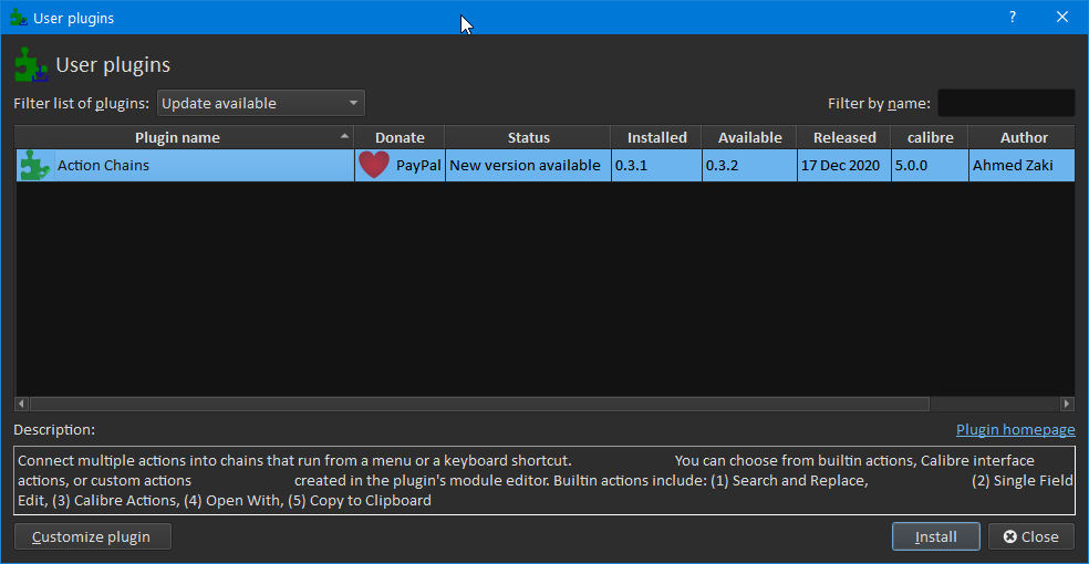

Problem Installing Plugin
Hi
I spotted the plugin so thought I would have a look at it.
I downloaded the file but it will not install. I get the following error. I have Windows 10 Enterprise, Calibre 5.4.
calibre 5.4 [64bit] embedded-python: True is64bit: True
Windows-10-10.0.17763 Windows ('64bit', 'WindowsPE')
('Windows', '10', '10.0.17763')
Python 3.8.5
Windows: ('10', '10.0.17763', '', 'Multiprocessor Free')
Interface language: None
Successfully initialized third party plugins: Comments Cleaner (1, 3, 1) && Diaps Editing Toolbag (0, 3, 7) && EpubCheck (0, 2, 3) && EpubMerge (2, 11, 0) && EpubSplit (3, 0, 0) && Fantastic Fiction (1, 4, 0) && Fantastic Fiction Adults (1, 2, 0) && Favourites Menu (1, 0, 5) && Find Duplicates (1, 8, 3) && Generate Cover (2, 0, 1) && Job Spy (1, 0, 188) && Modify ePub (1, 6, 1) && Open With (1, 5, 13) && Quality Check (1, 11, 0) && Resize Cover (1, 1, 0) && ScrambleEbook (0, 4, 5) && Search The Internet (1, 8, 0)
File "calibre\gui2\preferences\plugins.py", line 317, in add_plugin
File "calibre\customize\ui.py", line 472, in add_plugin
File "calibre\customize\ui.py", line 61, in load_plugin
File "calibre\customize\zipplugin.py", line 285, in load
File "importlib\__init__.py", line 127, in import_module
File "<frozen importlib._bootstrap>", line 1014, in _gcd_import
File "<frozen importlib._bootstrap>", line 991, in _find_and_load
File "<frozen importlib._bootstrap>", line 975, in _find_and_load_unlocked
File "<frozen importlib._bootstrap>", line 671, in _load_unlocked
File "calibre\customize\zipplugin.py", line 177, in exec_module
File "calibre\customize\zipplugin.py", line 173, in get_code
File "calibre_plugins.action_chains.__init__", line 25
"You can choose from builtin actions, Calibre interface actions, or custom actions "
IndentationError: unexpected indent
Thasaidon is offline   Reply With Quote

Try the new attachment, hopefully it solves the issue.

Small glitch: The formatting appears a bit strange in the plugin updater.
Name:	2020-12-17 15_50_26-User plugins.png
