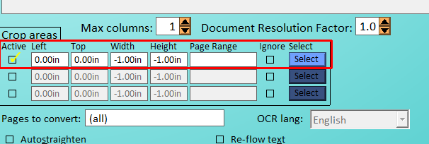

Originally Posted by willus View Post
Any idea why k2pdfopt is trying to save in the "Torrents" folder? Your source file does not appear to be in that folder so you would have had to explicitly direct k2pdfopt to save into that folder. If the Torrents folder doesn't exist, that is the problem. It's either that or (1) you don't have permission to write into that folder, or (2) you are out of disk space (less likely since it can't even open the file).
Thanks for the answer!
Aparentelly my antivirus was blocking k2pdfopt from opening the file. But now I´m doing some tests and I wonder: is there a way to do an autocrop of a scanned pdf to take away the margins (including those dark edges due to copying artifacts) while, at the same time, maintaining the content of each original page (not mixing pages together)? Thanks!
kleber is offline   Reply With Quote
Old 12-01-2020, 10:42 PM   #1828
willus
Fuzzball, the purple cat
willus's Avatar
Posts: 1,314
Karma: 11087488
Join Date: Jun 2011
Location: California
Device: iPad
Yes--see the -ac option in the command-line usage page. Something like this:
k2pdfopt -mode tm -ac myfile.pdf
The autocrop (-ac) option can give mixed results. You'll have to see if it works for you. If the page contents are in a consistent location page to page, you can also assign a manual crop box using the section of the gui shown in the attachment.
