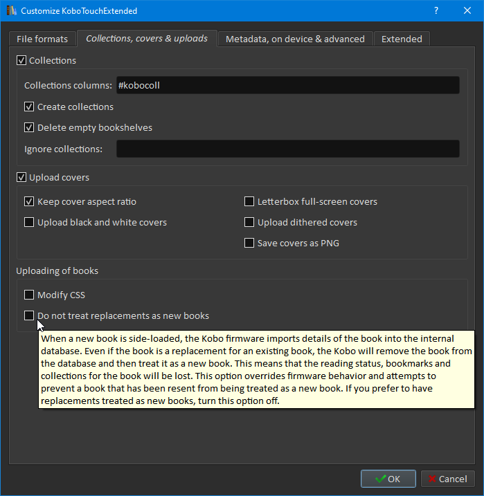

I set KoboTouchExtended to treat replacements as new books because otherwise the ToC (which is stored in the database for some reason I don't understand - maybe davidfor knows?) didn't update correctly whenever I synced fanfic updates. This deletes the old book and then uploads it as a new one:
Name:	2020-11-30 16_42_37-Customize KoboTouchExtended.png
However, this means that I have to eject the device, let Calibre import my updated book to create the new database entry, then plug it back in to restore the bookmarks/set the font settings again.
Attachment 183701
If you do that, then yes, when you resend a book the collections will not be there. The problem is that the driver will update the collections. But, when the device detects the book has changed, it removes the book details from the database. That includes the collection information. There isn't a way to beat this. The driver is already cheating when it sets the collections when sending a new book. That works as the device doesn't touch the collections for new books and the database keys are predictable.
