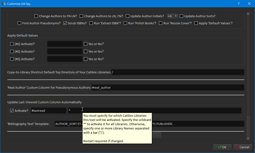

I would also check that you didn't accidentally restrict it to specific libraries.

Mine is set up the same way.
