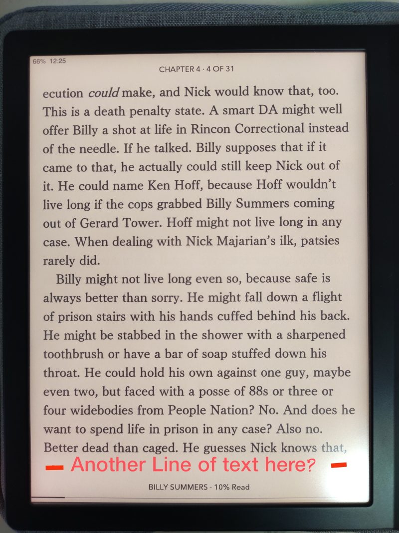

Device: Kobo Libra 2, Boyue Likebook P78
So i want to reduce the space between the last text on a page and the footer (Book Title and page and progress bar) and so I looked at the yaml and found the patch below. However i do not understand some of the requirements in the instruction like "uncomment part here":
Un-comment and customise ONLY ONE of the following to change header/footer font-family
#- {Find: "font-family: Avenir;", Replace: "font-family:Avenir;"}
#- {Find: "font-family: Avenir;", Replace: "font-family:Avenir; background:transparent;"}
# Hint:
# Even if you don't need to change font-family you might want to un-comment the 2nd Find/Replace above.
Can somebody tell me what is meant by "uncomment" and if I want to use my own font, where should I put it in the patch line? example i want to use helvetica that is in the fonts folder, how do i direct the patch to the helvetica?
my fw is 4.28.18220 Kobo Libra
EDIT: Figured it out. Thank you
