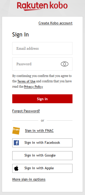

Well, then, I'll consider myself lucky that my two FNAC-bought devices are happily sticking to the (manually set) "kobo" affiliate, then. They've never seen hide nor hair of a Kobo via FNAC account, though, they're both on the same pure Kobo one.
(But, yeah, if I factory reset them, I'd expect them to go back to the fnac affiliate).
EDIT: @JSWolf: Yes, which is what I meant by my "Kobo via FNAC" comment. c.f., the Kobo log-in page from a French IP.
