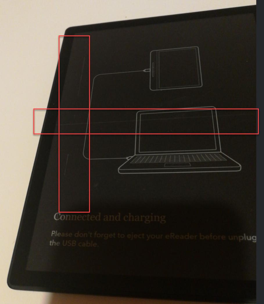

is my kobo forma screen broken(horizontal and vertical line)
got strange horizontal line and vertical line on the screen, it doesn't go away even after factory reset, not sure whether the screen is broken or something, did anyone have similar issue?
I have a similar vertical line in my screen. I can't see in your picture whether it's 'negative' (dark line on a light background, light line on a dark background) as it is with my Forma.
It's probably a screen driver issue. I'm living with it until it gives up the ghost completely.

It may be broken, but looks like a controller problem. Is the vertical line completely straight or any curve/jag in it (would indicate broken)? You'll be able to tell when you turn it on and start flipping pages -- if it's broken parts of the screen won't update.
Of course, a controller problem could also be considered broken -- I'd say it's a hardware issue one way or the other.

If it's under warranty I'd ask them if it can be exchanged.
The typical problem with a vertical line is a fuzzy one on the side by the buttons, caused by some design failure; it goes away if I turn down the brightness.

The Forma uses a flexible plastic TFT, it wouldn't showcase the usual glass cracks shown on earlier... glass TFT when they... crack .
That, on the other hand, could be a badly seated flex cable. Or something worse. So, yeah, if it's under warranty, call CS.
And, no, this has nothing to do with the Forma's famous frontlight sidebar of doom (because, first: duh. And, second, the frontlight is off on the "connected to a computer" screen).

thanks all for the reply, i think this is definitely a hardware problem, it's not going away no matter what i do with the reset etc.., and now i got 2 vertical lines instead of 1, they are showing as negative line, similar to this one

My Forma developed the same problem yesterday. Two perfectly straight thin lines. One horizontal, one vertical. Have yours gone away?

Either broken, or if you are very lucky the ribbon connection needs remounted.

Remember that the Forma has a plastic TFT, so it's potentially more likely to be a badly seated cable than a broken screen than on other devices .

I had a Sony Reader PRS-505 that had a vertical line show up on screen. Eventually, the screen under the line stopped updating and remained blank. It wasn't a problem screen. I would say a controller fault.

Anyone mangaged to fix this issue by opening the device up and trying to reseat the cable? My Forma developed such a line a week a go and this bothers me way more than it should. Unfortunately a reset didn't help and it's out of warranty

In case if someone is interested: I now opened up my Forma to see if I can fix the issue. The connector for the display flex cable seems to be fixed with glue, so a loose or shifted flex connector is very unlikely to happen. It also didn't do anything for my problem. Maybe I will be able to get a damaged unit and do a display swap.
