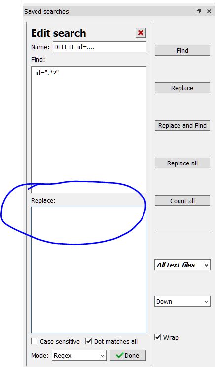

I make each Find & Replace a Stored Search, then select a group of Stored Searches and do a [Replace All]
It's my habit to put an 'identifier' (e.g. TAG) in the title and arrange the Stored Searches to make it easy to group select them

When you have a search set up, right-click on it and save it. Then you can run it from "saved searches", or edit it and then run it, and so on. You can select several saved searches and run them all with one click (with due care).
Your examples and those of @phossler look a lot like mine, and other lists I've seen...we all seem to end up dong the same sorts of things, if in slightly different ways.

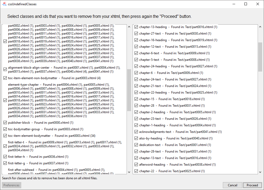

cssRemoveUndefinedClasses is the plugin that handles that task for Sigil. This is one of the reasons I use both editors since each has strengths. I've attached a sample image after clicking proceed in cssRemoveUndefinedClasses's popup.

I tried to save a search and the first one <body [^>]*> to <body class="calibre"> saves OK and shows up in new pop-up window.
However, with the second expression to remove the IDs [ id="[^\"]*"] I have to leave the 'replace with' field blank.
The editor refuses to save that and all the other 'replace-with-nothings' in the list. At least, they don't show in my list. ???
I have many 'replace with nothing' saved searches

I wasn't aware I had to name each and every one of the saved searches, then click 'done' to save it. That's why the other ones didn't get added. I did finally figure it out and was able to make a small list.

Old 11-10-2020, 04:22 PM   #15
retiredbiker
retiredbiker ought to be getting tired of karma fortunes by now.retiredbiker ought to be getting tired of karma fortunes by now.retiredbiker ought to be getting tired of karma fortunes by now.retiredbiker ought to be getting tired of karma fortunes by now.retiredbiker ought to be getting tired of karma fortunes by now.retiredbiker ought to be getting tired of karma fortunes by now.retiredbiker ought to be getting tired of karma fortunes by now.retiredbiker ought to be getting tired of karma fortunes by now.retiredbiker ought to be getting tired of karma fortunes by now.retiredbiker ought to be getting tired of karma fortunes by now.retiredbiker ought to be getting tired of karma fortunes by now.
retiredbiker's Avatar
Posts: 479
Karma: 3972002
Join Date: May 2013
Location: Ontario, Canada
Device: Pop_Os!, Kobo Forma
Originally Posted by G2B View Post
Rather than reinventing the wheel, are there any such saved listings available from people who've shared theirs?
There is actually a sticky for that: https://www.mobileread.com/forums/sh...d.php?t=237181
I think a problem is, especially for regex searches, they can be dangerous. I may save one, knowing I can safely run it on this book, but it will destroy that book. Or I may expect to edit a search every time I need it, but someone else may not realise that, and it will fail.
retiredbiker is offline   Reply With Quote
