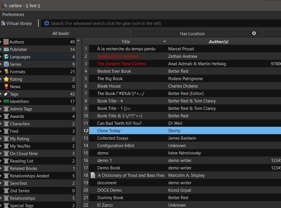

  2. It is hard to see the current item if Windows Dark mode is set. In this screen shot the current item is Languages:
Name:	Screenshot 2020-10-24 085141.jpg
    Perhaps it could have the same contrast colour as the book list. If it was only used when the TB had focus, it would also act as signal that the TB has focus.

Do you mean when the shortcut is used the first time? There is currently a problem if the shortcut is used without ever having selected another node. Effectively the TB is given focus but no node is highlighted. Hitting the down arrow key selects the top node. Is this the problem you are referring to?

The focused item in the tb is now highlighted.
