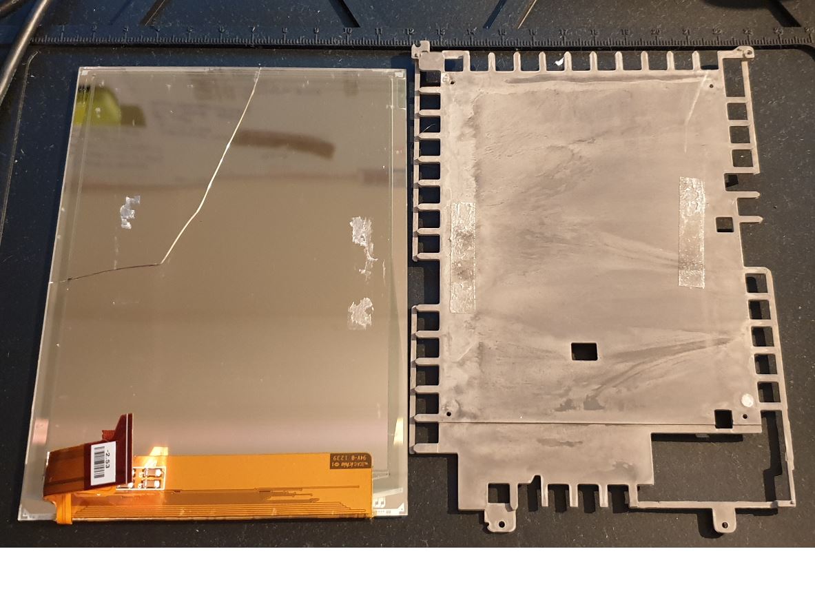

This is not a job for the faint-hearted!
Got it torn apart and the screen off, you can clearly see the damage on the back of the screen. I made it worse taking the screen off but it was obviously already damaged.
The physical damage was not visible at all however, until I got the screen off. It manifested as lines on the screen in the damaged area and no response to touch.
Will be ordering a new screen (few weeks for delivery) and having fun installing it without breaking it...

Photo attached.

The new screen is a little smaller then the original one. in lenght like 2-3 mm in widht it's exactly the same.
All is working smooth, books are readable again so thank you dom123dom for pointing me in the right direction!!!

Ordered the screen from Aliexpress, all costed around €17. used only a pocketknife and little screwdrivers.

I just broke my screen today. Thankfully this was my replacement kobo I bought a month ago after I lost my original one. I since found that original one but now this one is broken!
Did the screen look identical to you visually HerbieNL? Aside from the dimensions being a touch off, would you say the contrast/sharpness of image was bang on?
Thanks for your time regardless!
Hi Gergith,
And again, a week after the reaction, I get an email with there is a reaction to your post..
But for your question, yes I think the contrast and sharpness is bang on. Like you I already bought a new one, but the repaired one is now heavily used by my 2 sons (10 and 11)and like McDonalds there loving it . I'm very happy with the replacement screen (aside of the money difference in buying a new lcd screen in Holland or in China).
Hope I could help with your decission
HerbieNL is offline   Reply With Quote
