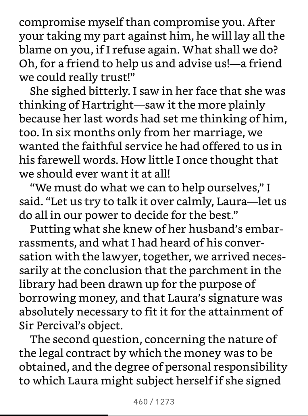

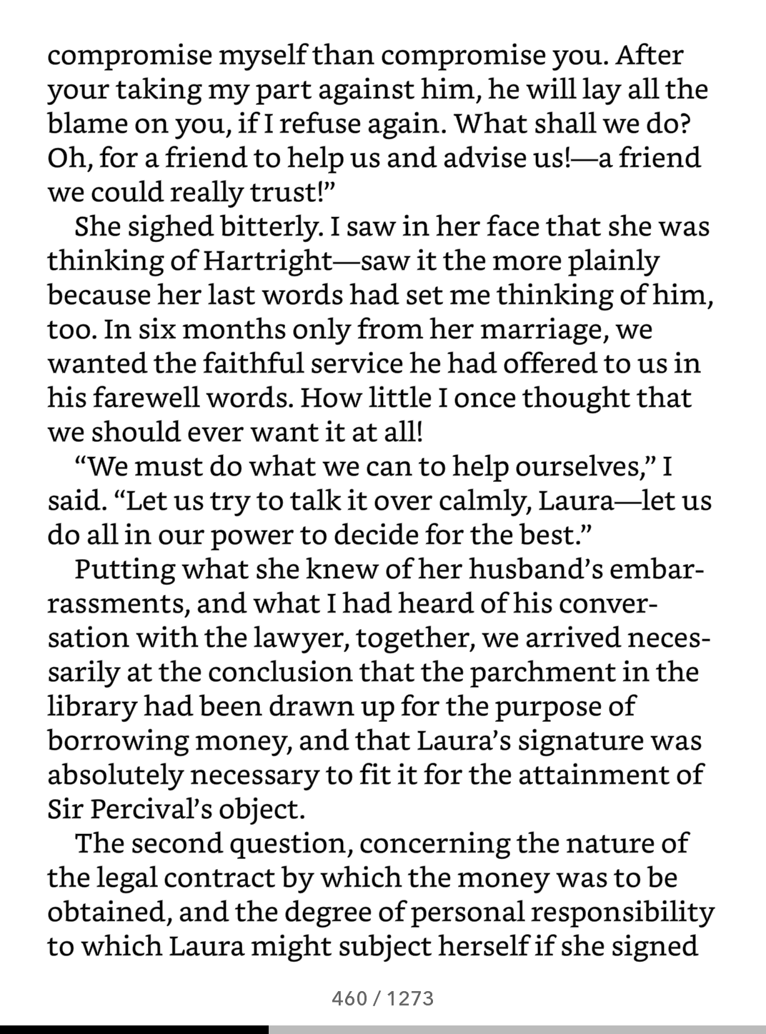

Progress Bar Tweaks
I asked this a year ago, when the progress bar was a new addition to the firmware, and there didn't seem to be any interest in working on a patch for this, BUT...
Is it possible to adjust anything to do with the progress bar? It appears that in the last year Kobo has expanded the bar to span the entire width of the screen, which I like, but I would LOVE to be able to move the bar to the very bottom of the screen. The white space gap just looks awkward to me. It would also be amazing to be able to change the thickness and color of the line.
So, wondering if these things can possibly be adjusted:
1) Progress bar vertical position. Moving it 12 pixels down would have it rest at the bottom of the screen.
2) Line thickness of "read" and "unread" bars.
3) Color of "read" and "unread" bars.
Adjusting these things could really refine the look of the progress bar, making it appear more sleek and less "clunky" (to my eyes). I have attached screenshots of various mockups to fit my Clara screen, and I when I view them on my device, I feel these would be amazing upgrades to the look of the progress bar.
If it's at all possible to tweak these things through a patch, let me know. And if no one is wanting to work on it, I would even consider getting into coding, JUST to figure this out!
Thank you to anyone who has any input regarding the feasibility of this.
Images:
Stock progress bar
Stock bar lowered 12 pixels
10px thick black and gray bar
12px thick black and gray bar
12px thick gray and white bar
ID:	183072   Click image for larger version
ID:	183073   Click image for larger version
ID:	183074   Click image for larger version
ID:	183075   Click image for larger version
That's theoretically possible. I'll have to look into where the bar is drawn when I get a chance.
I also need to get around to updating the first post (I forgot to add a few recent requests).
Old 10-30-2020, 12:01 PM   #630
jackie_w
Posts: 6,327
Karma: 16800000
I cannot find any reference to this specific progress bar in the nickel CSS, hence no nickel.yaml patch.
The progress bars I did find details for in nickel appear elsewhere in the GUI, e.g. the in-book kepub chapters barchart and the Activity>Reading Stats page.
ETA: There is one long shot I can try. More later.
ETA2: No, I'm afraid that didn't work.
