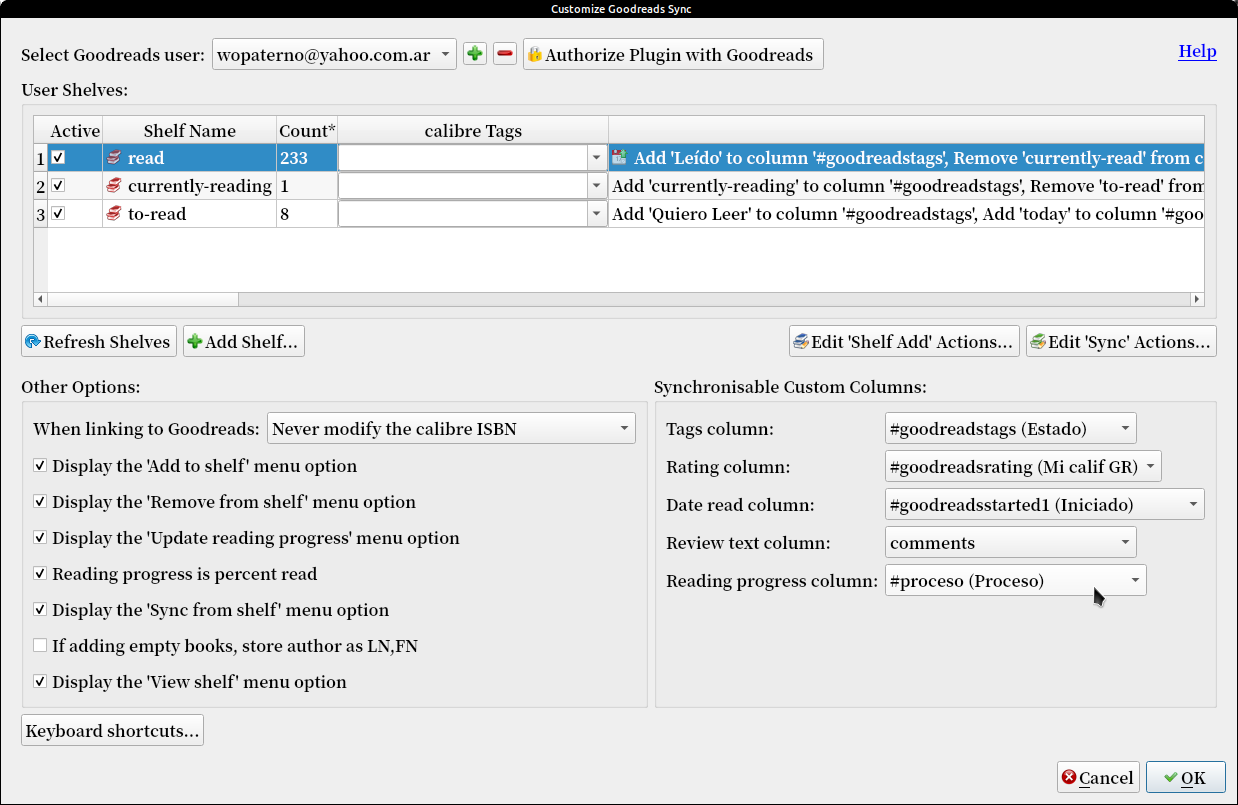

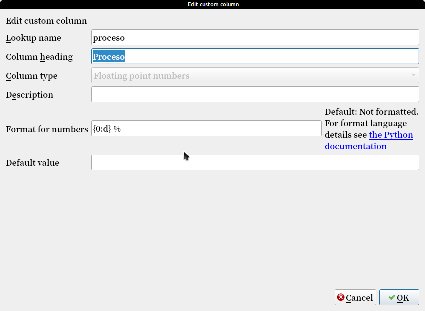

It updates GR from a custom column. The assumption is the column contains the percentage read for the book. You just add a column and then set this as the "Reading percent column" in the configuration.
Let me see if I got this right.
I create a custom column
Query name: precesses
Column heading: Processes
Type: whole numbers
Number format I put {0: d}% to show the percent sign. (image 1)
Then in the plugin configuration in the reading process column configuration I select #processes (image 2) and restart calibre.
When I synchronize the reading list, the percentage should appear.
But it does not appear, will I need to configure something?
From already thank you very much

If I'm not wrong, the progress goes from calibre to goodreads, not the other way.
I thought so...
I had tried with integers and decimal numbers and nothing.
Thank you very much
Type: whole numbers
The only change I would make to that the process once the configuration is done is:
- Update the progress for the books in calibre.
- Select the books in calibre and use the "Update reading progress" option in the plugins menu.
- Make any changes you want on the dialog (match books to GR, add a comment or edit the progress or rating).
- Press OK to update GR.
And as the Terisa said, it is calibre to GR only. The reason the function exists is that I can fetch the reading progress from my Kobo devices and decided I wanted to update GR with this. I haven't seen a reason to pull the progress from GR, and I don't remember anyone has requesting it.
