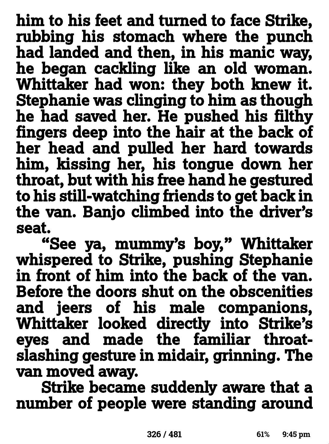

I have my page setup exactly like johnnydarko's sample... no header, and only the page number shown exactly as he has it. It sounds like it shouldn't be working for me either, but it does? Here's a sample of my epub page (Firmware 4.24.15676 on the GloHD).

You could get the whole header/footer to display in a custom font by either
  1. Completely replacing the firmware's installed Avenir font with a font of your own renamed, internally and externally, to 'Avenir Next'.
  2. Sideloading a "shadow" copy of your custom font to the /fonts directory, renamed similarly, internally and externally, to 'Avenir Next'.
It sounds like you're using option 2.
Both require use of a font editor and will affect parts of the GUI you may or may not have wanted to affect. In other words, more involved than simple patch enabling. So I wouldn't normally suggest them as options to new users until it's obvious that they're very comfortable with hacking/patching.
If anyone wants to do this GUI font hacking, they should read this thread then decide how they want to proceed.

Ah, so that's why it wouldn't work before for me unless I put a copy of Georgia font into my fonts directory on the reader where all my custom fonts were. I could never figure that one out.
Thanks for the explanation. I'm just glad it's working for me.

One odd (and I'll admit really picky) thing my screenshot above pointed out to me was that this firmware has the page number located one pixel lower. I always keep the battery and time on the same line and I could see the difference in the screenshot. I made sure it wasn't just a fluke of the current book, and had to lower the placement of the battery and time by one pixel. But my other reader on 4.20.14622 did not need that adjustment.
