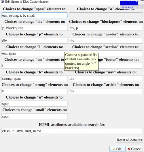

Request
Please consider upgrading Tag Mechanic in Sigil to have the same features as Tag mechanic in in Calibre.
I much prefer your Calibre version.
Speaking from a position of ignorance, could a goodly portion of the Tag Mechanic code in Calibre not be used in a new Sigil version?
Thasaidon is offline   Reply With Quote

Can you explain what features of the Span/Div Editor portion of my calibre Toolbag plugin you feel are different (or missing) from Sigil's Tagmechanic?
Keep in mind that the visual diffing capabilities of the calibre plugin are only possible because calibre itself provides that functionality--lock, stock and barrel. My plugin just "flips a switch" to display it. In that regard, there is unlikely to ever be a similar feature in the Sigil plugin itself. Sorry. Use Sigil's checkpointing feature if you want to see visual diffs of the changes a plugin makes (and to revert them if necessary).
In the Calibre version the Tag Mechanic the toolbar button has a switch. Clicking on the switch gives you a small menu (see screenshot). Takibg the first option is makes Tag mechanic "only affect the current file". If not taken it works on all files.
The Second option "Configuration" allows you to add/change "tags" that Tag Mechanic will work on. See larger screenshot below.
Unless I have missed something in the the Sigil version of Tag mechanic (NOT Unknown ). There is nothing in the Sigil version like this.
Please tell me if I am wrong and how to get the options I am talking about.
You are wrong and have missed something(s).
The Sigil version is actually more granular in this regard. You simply select the files in Sigil's BookBrowser (before running the plugin) that you want the plugin to process. If you have one file selected, it will process that one file. If you have all files selected, it will process all of them. If you have some subset of all of the files selected, it will process that subset of files.
Right-click somewhere on the plugin's user interface to bring up the config menu.
The interface will be changing soon (to PyQt5 which will look nearly identical to Sigil's UI), so that last one will be changing a bit. It will be available via a standard menu item rather than the current right-click.
