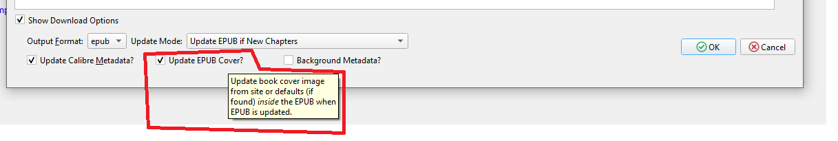

You've already linked to my answer and it hasn't changed, but I'll quote it again here for others:
What we're discussing is a change to menu/GUI organization with minimal change to functionality.
What you wanted turned out to be a surprisingly complex problem of changing how the system works.
No problem. And I don't want to annoy you with it.
I just had the idea that with the "update EPUB Cover" option on present update option
and if you add the new "only update metadata" thing it could be feasible.

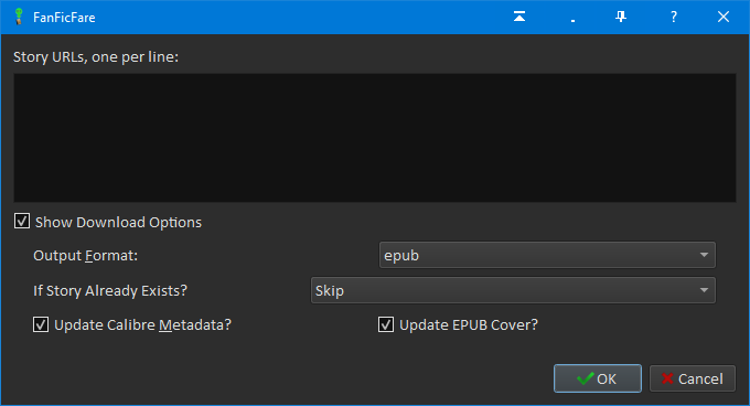

There's two different dialogs. The Download New URL (which the URL scraper passes the URLs into) does have skip:
Name:	2020-10-17 16_33_23-FanFicFare.png

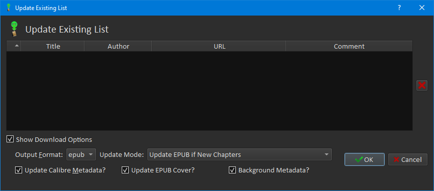

The Update Existing doesn't:
Name:	2020-10-17 16_34_30-Update Existing List.png

There are exactly two dialogs that do multiple duty:
add_dialog takes a list of URLs, which can come from user input, clipboard, dragged from different sources (including emails in thunderbird), 'From Web Page', or from email. There's significant logic involved in looking for existing books that match the story URLs given. (When invoked for an anthology (or anthology update), the download options are hidden.)
update_dialog takes a list of existing Calibre books. And... that's it? Huh, I guess it's mostly on add_dialog.
