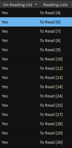

However, note this:
Name:	2020-10-15 00_00_47-Window.png
(missing numbers are because I'm in a virtual library)
Sort #readorder first, and make sure it's ascending. Then you sort by #onreadinglist.
It requires two steps but it'll get your reading list on top of the list and in order.

However, note this:
Attachment 182736
Thanks ownedbycats
