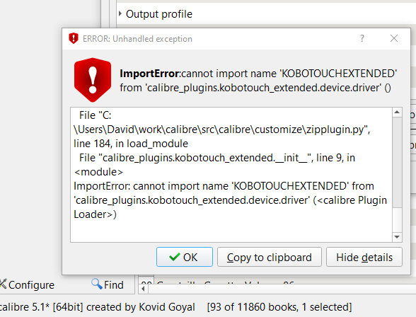

I was noticing that the KoboTouchExtended, Kepub Input, Kepub Output, Kepub Metadata Reader and Kepub Metadata Writer plugins were all removed. An attempt to reinstall gave an ImportError message similar to the one from the KoboTouchExtended driver. This seems to be an issue with the import line in _init_.py.
from calibre_plugins.kobotouch_extended.device.driver import KOBOTOUCHEXTENDED
from calibre_plugins.kepubin.conversion.kepub_input import KEPUBInput
from calibre_plugins.kepubout.conversion.kepub_output import KEPubOutput
from calibre_plugins.kepubmdwriter.metadata.writer import name KEPUBMetadataWriter
from calibre_plugins.kepubmdwriter.metadata.writer import KEPUBMetadataWriter
Edit: To be a total pain, they will install in debug mode and survive a calibre shutdown and restart into debug mode. A normal calibre startup happily removes them.
Edit2: Running from source does not let me install. See attached image.

I have done some playing, and the problem appears to be with importing from "calibre.ebooks.oeb.polish.container". If this is done when the plugin is loaded, it will fail. If it is done later, it works. I have no idea why. I assume it is related to the thread-safe issues with importing in Windows, but, I am not sure. Or, it might just be that what we were doing was wrong.
The attached beta is a quick-and-dirty hack to move the import to when it is actually needed. I have not done much testing, but it seems to work for the few books I have tried.
If this works for others, I'll look at the other kepub plugins as well.
Sorry but for me, the install errors out either running the binaries or running from source. BTW, was the run.cmd supposed to be in the .zip file?
calibre, version 5.1.0
ERROR: Unhandled exception: <b>ImportError</b>:cannot import name 'KOBOTOUCHEXTENDED' from 'calibre_plugins.kobotouch_extended.device.driver' (<calibre Plugin Loader>)
calibre 5.1* [64bit]  embedded-python: True is64bit: True
Windows-10-10.0.19041-SP0 Windows ('64bit', 'WindowsPE')
('Windows', '10', '10.0.19041')
Python 3.8.5
Windows: ('10', '10.0.19041', 'SP0', 'Multiprocessor Free')
Interface language: None
