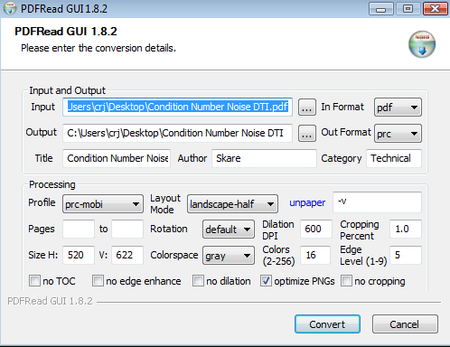

Old 04-14-2009, 01:00 PM   #238
crj
Professor
crj began at the beginning.
Join Date: Apr 2009
Location: Salt Lake City
Device: Kindle2
PDFRead settings for technical papers (pdf) on the Kindle 2?
Hi,
I am trying to find the best settings for PDFRead to read technical papers with lots of equations on my recently acquired Kindle 2. Thanks to Nick Rappalo, I've been able to iterate to what seem to be good settings (see attached screen capture below), however, I would be very interested if others have found better settings.
Thanks!
Chris (crj)
crj is offline   Reply With Quote
Old 04-14-2009, 02:33 PM   #239
nrapallo
GuteBook/Mobi2IMP Creator
nrapallo's Avatar
Posts: 2,958
Karma: 2530691
Location: Toronto, Canada
Originally Posted by crj View Post
Hi,
I am trying to find the best settings for PDFRead to read technical papers with lots of equations on my recently acquired Kindle 2. Thanks to Nick Rapallo, I've been able to iterate to what seem to be good settings (see attached screen capture below), however, I would be very interested if others have found better settings.
Hi Chris:
Those settings look good.
Especially when using the new MinFilter 5 dilate (see pdfread-MinFilter5-mod-bin.zip) provided with the Sony PRS update. However, that update is still of interest even for Kindle users.
Just a note that if the original .pdf is of high quality/resolution and the DPI setting is too high, then the dilation effect can be reduced/negated unless using the new MinFilter 5 dilate.
Cheers and welcome to MobileRead.com!
