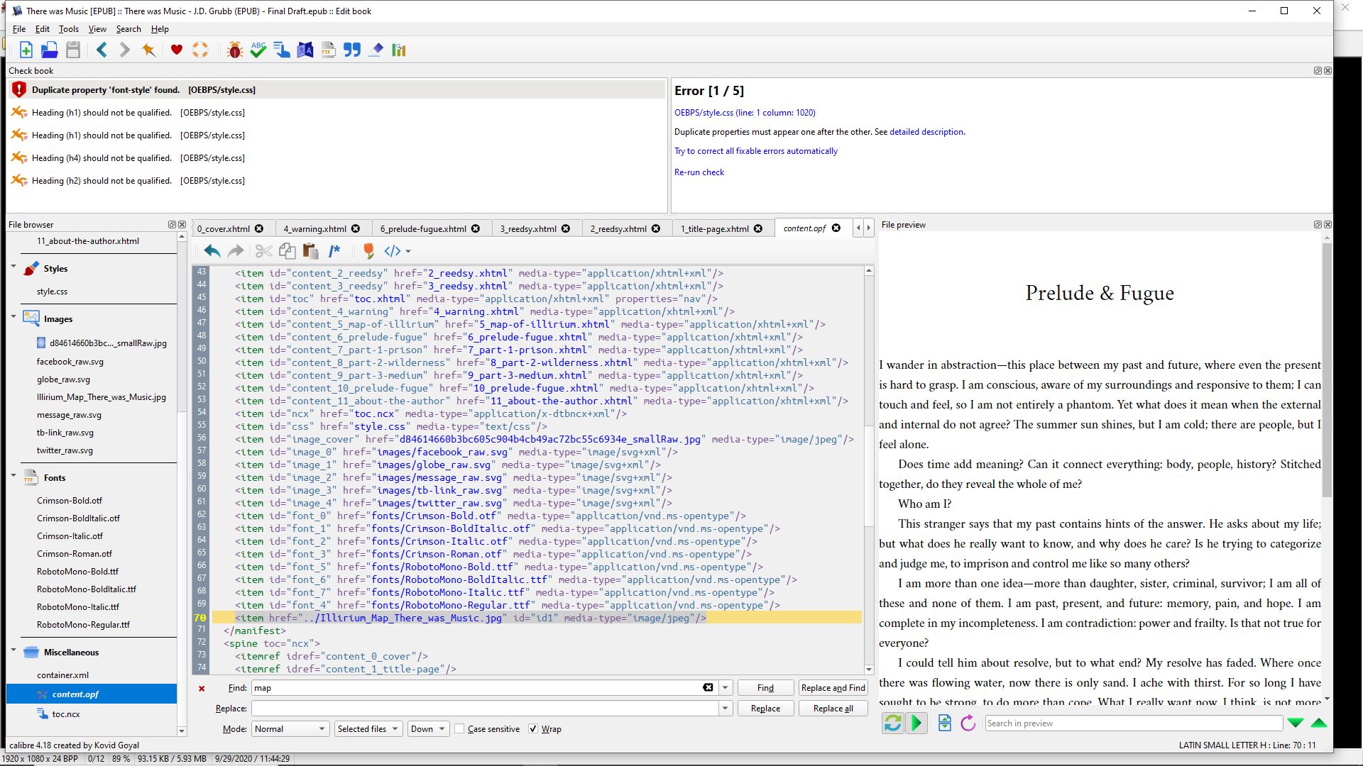

Broken EPUB (missing files): JPEG Image not listed in manifest
General Problem
I keep getting an error message when I try to upload my EPUB file on Smashwords:
"File 'Illirium_Map_There_was_Music.jpg' in EPUB not listed in manifest! Your .epub file is missing one or more elements in its manifest. . . ."
After extensive review, and scouring the internet for troubleshooting solutions, I cannot figure out how to resolve this. I have run the EPUB through another EPUB Validator, which finds no errors (see attached screenshot), and reviewed the manifest manually using Calibre (via the content.opf listing - see attached screenshot), which shows the image in question as part of the manifest - with consistent naming. Moreover, the files are clearly listed in the directory, and no other aggregator site has raised this problem with the exact same EPUB file.
Smashword Response, Part 1
I contacted the Smashword Service Team, and using my actual EPUB file, a member reviewed it with their tech team. He responded:
"I had our techies take a look at the EPUB and they suspect it's due to the formatting of the underlying HTML for that particular file in your EPUB manifest. Specifically, they suspect it's due to the "../" in the HTML for the file in question:
<item id="id1" href="../Illirium_Map_There_was_Music.jpg" media-type="image/jpeg"/>
By contrast, your other elements include the exact directories, e.g.:
<item id="image_cover" href="Images/d84614660b3bc605c904b4cb49ac72bc55c6934e_smallRaw. jpg" media-type="image/jpeg"/>
<item id="content_8_part-2-wilderness" href="Text/8_part-2-wilderness.xhtml" media-type="application/xhtml+xml"/>
Updating the href attribute to explicitly include the entire directory will likely fix the issue.

I originally entered that image using Calibre, while the rest of the EPUB was generated by Reedsy, the former took the complete file name "Illirium_Map_There_was_Music" and added the ".../" preceding it for some reason. I've tried removing and re-adding the image file a couple times, but the same result occurs.
Trying to edit the ePUB manually, I do not appear to be able to change the registry listing (i.e. removing the ".../") without creating a link error within the EPUB, which removes the image.

look at the OPF entry for that file.
now look at the other images entries
it is missing images/<filename>

Thanks for providing feedback. I had tried that, and tried it again; but writing in "images/" ahead of the file name (in place of "../") and the file placement location and/or the OPF appears to break the link, removing the image from view.
Did you try 'images' with a capital 'I' ? I think it is case sensitive.

Thank you for the additional thoughts. I tried that, both ways ("Images/" or "images/") not yielding productive results.
I even tried shortening the file name, wondering if the "../" was due to a longer name, but that didn't make a difference.
Moreover, I experimented by adding a new random file from my computer, which was also given a "../" before the file name, so that suggests a Calibre default.
Does anyone know how to do this, if that is indeed the problem?
If EPUBCheck didn't report any problems, it's definitely a SmashWords problem.
The following might work for you:
  1. Open the book with Sigil.
  2. Select Restructure Epub to Sigil Norm.
  3. Save the epub under a different name.
  4. Check the new epub with EPUBCheck.
  5. If EPUBCheck doesn't report any errors, upload the new epub to SmashWords.
Thank you for your feedback. This was definitely the simplest approach (and worked). I suppose this suggests some quirk with Calibre; though, again, I had no problems with all the other aggregators (Amazon KDP, B&N, Kobo, etc.) using the ePUB file mildly edited using Calbre that had been flagged by Smashwords. Anyway, point to Sigil for helping this problem.
