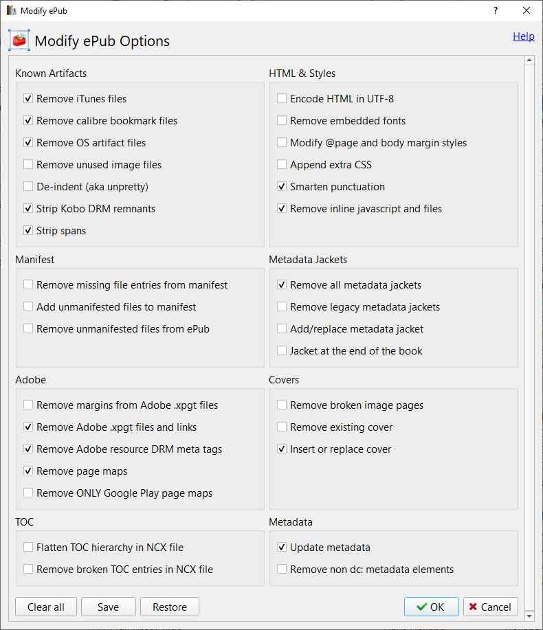

Yet another test version. This one corrects problems caused image files.
On my computer, version 1.5.4 abended in container.py line 14.
calibre, version 5.0.1 (win32, embedded-python: True)
Failed to modify ePubs: Failed: Modify ePubs
Modify ePubs
  File "runpy.py", line 194, in _run_module_as_main
  File "runpy.py", line 87, in _run_code
  File "site.py", line 89, in <module>
  File "site.py", line 84, in main
  File "site.py", line 55, in run_entry_point
  File "site-packages\calibre\utils\ipc\worker.py", line 215, in main
  File "site-packages\calibre\utils\ipc\worker.py", line 143, in arbitrary_n
  File "importlib\__init__.py", line 127, in import_module
  File "<frozen importlib._bootstrap>", line 1014, in _gcd_import
  File "<frozen importlib._bootstrap>", line 991, in _find_and_load
  File "<frozen importlib._bootstrap>", line 975, in _find_and_load_unlocked
  File "<frozen importlib._bootstrap>", line 655, in _load_unlocked
  File "<frozen importlib._bootstrap>", line 618, in _load_backward_compatible
  File "site-packages\calibre\customize\zipplugin.py", line 184, in load_module
  File "calibre_plugins.modify_epub.jobs", line 14, in <module>
  File "calibre_plugins.modify_epub.modify", line 22, in <module>
  File "calibre_plugins.modify_epub.container", line 14, in <module>
ModuleNotFoundError: No module named 'urlparse'
See attached image for the options used though I suspect it's not getting that far.

That is very strange. It is saying that the plugin can't import a standard calibre module, in this case six.moves.urllib.request. What OS are you using?
I looked at the 1.5.4 container.py file and lines 10 to 15 read:
import os, posixpath, sys, re, urllib
from lxml import etree
from lxml.etree import XMLSyntaxError
from urlparse import urldefrag, urlparse, urlunparse
from urllib import unquote as urlunquote
while the 1.5.3 container.py file has:
import six
from six.moves import range
from polyglot.builtins import unicode_type
__license__   = 'GPL v3'
__copyright__ = '2011, Grant Drake <grant.drake@gmail.com>'
__docformat__ = 'restructuredtext en'
import six.moves.urllib.request, six.moves.urllib.parse, six.moves.urllib.error
from io import open
from six.moves.urllib.parse import urldefrag, urlparse, urlunparse
from six.moves.urllib.parse import unquote as urlunquote
I copied the segment from the 1.5.3 container.py into the 1.5.4 container.py and now I get a different error message. I tried 4 or 5 single options and the same error.
ERROR: Modify ePub failed: No ePub files were updated
Modify ePubs
  Modifying:  C:\Users\David\AppData\Local\Temp\calibre_y3si84vr\81p9w4o7_modify_epub\9905.epub
Dealing With Demons - ERROR: Traceback (most recent call last):
  File "calibre_plugins.modify_epub.modify", line 60, in process_book
  File "calibre_plugins.modify_epub.modify", line 942, in _setup_user_options
  File "calibre_plugins.modify_epub.modify", line 921, in get_user_margins
AttributeError: 'GuiRecommendations' object has no attribute 'iteritems'
ePub not changed after 0.04 seconds
This is with calibre 5.0.1, Windows 10 x64.
