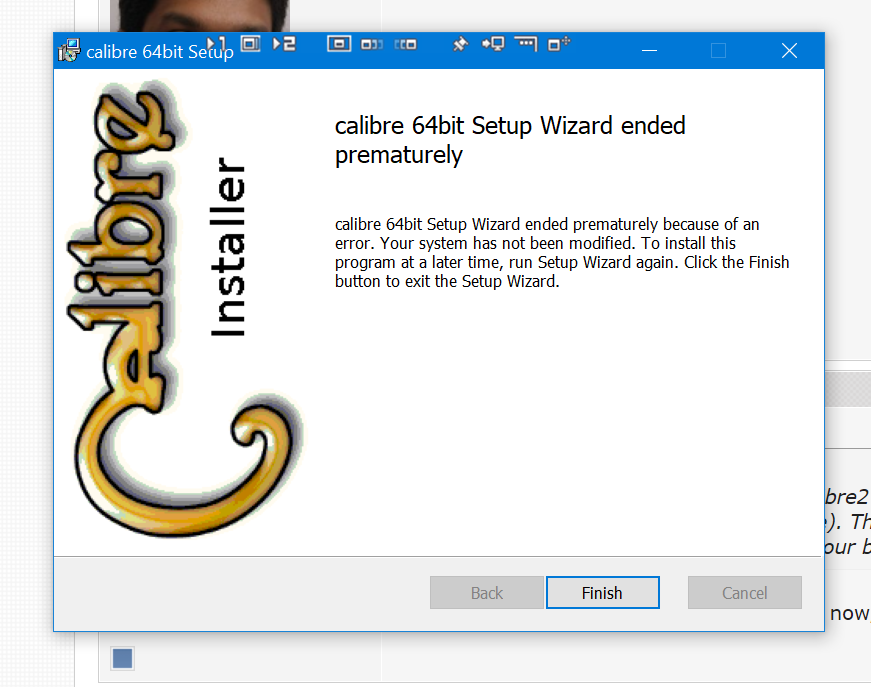

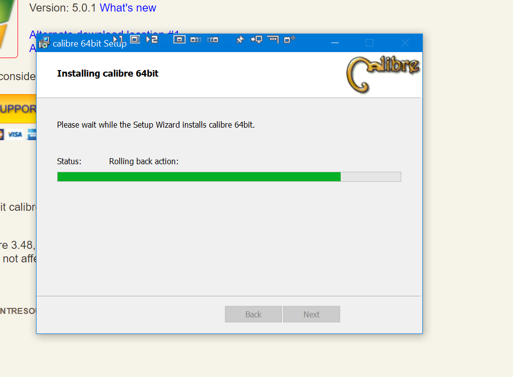

Good Evening,
I am not able to install 5.0.1. at this time. I started the first install and after checking the permission box and the install box the process started. Started to copy new files and then stopped, displaying the message on the right. When all is said and done the message on the right pops up.
I have deleted the program Calibre, uninstalled C:\\Program Files\\Calibre2\ and attempted to reinstall calibre. I have rebooted after the second attempt to reinstall and I get the same message. I would appreciate any suggestions. Please let me know what information I need to provide to assist in clearing up this matter.

@AgCotter: Disable/uninstall powertoys

Good Morning,
Appreciate your response to my issue. I removed power toys and ran the install. I got the attached message from the process. So I followed your original instructions of:
"Uninstall, delete C:\\Program Files\\Calibre2
(or wherever you chose to install calibre). Then re-install. And
don't worry, uninstalling will not affect your books/settings."
I added a reboot just for good measure, and success
You guys and gals rock.
