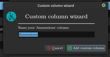

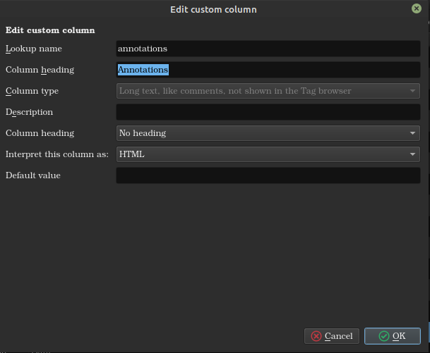

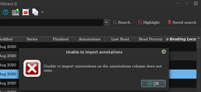

Until today, I had no problems syncing my annotations from my Kobo to my Calibre.
But today, it now says
"Unable to import annotations as the annotations column does not exist."
As the screenshots show, it does appear that the annotations column does in fact exist.
Can anyone please help?

Old 08-13-2020, 10:21 PM   #755
Posts: 49,511
Karma: 174632680
Try using #annotations as the lookup name.
To quote from the calibre documentation: "Names for custom fields (columns you have created yourself) always have a # as the first character."
The number of custom column names that have been posted starting with a # were not just for looks.
Old 08-14-2020, 12:13 AM   #756
davidfor
Posts: 24,905
Karma: 47303824
Location: Sydney, Australia
The first screenshot is the wizard to create the column. Did you restart calibre after creating the column? If you, the important screenshot is what is in the customization dialog of the plugin. Is the correct column selected there?
If that is correct, then please run calibre in debug mode, try the fetch and post the log after it fails. And turn the debug option in the plugin on before doing this.
Old 08-14-2020, 03:21 PM   #757
droopy
droopy ought to be getting tired of karma fortunes by now.droopy ought to be getting tired of karma fortunes by now.droopy ought to be getting tired of karma fortunes by now.droopy ought to be getting tired of karma fortunes by now.droopy ought to be getting tired of karma fortunes by now.droopy ought to be getting tired of karma fortunes by now.droopy ought to be getting tired of karma fortunes by now.droopy ought to be getting tired of karma fortunes by now.droopy ought to be getting tired of karma fortunes by now.droopy ought to be getting tired of karma fortunes by now.droopy ought to be getting tired of karma fortunes by now.
Posts: 834
Karma: 2912460
Join Date: Apr 2009
Device: Kobo Forma
Hi DavidFor.
Thanks for replying.
I enabled debug mode in the Annotations plugin and then restarted Calibre in Debug Mode.
I then ran “Fetch Annotations from Device” and now it’s successfully fetching the annotations. Strange. but a happy result.
