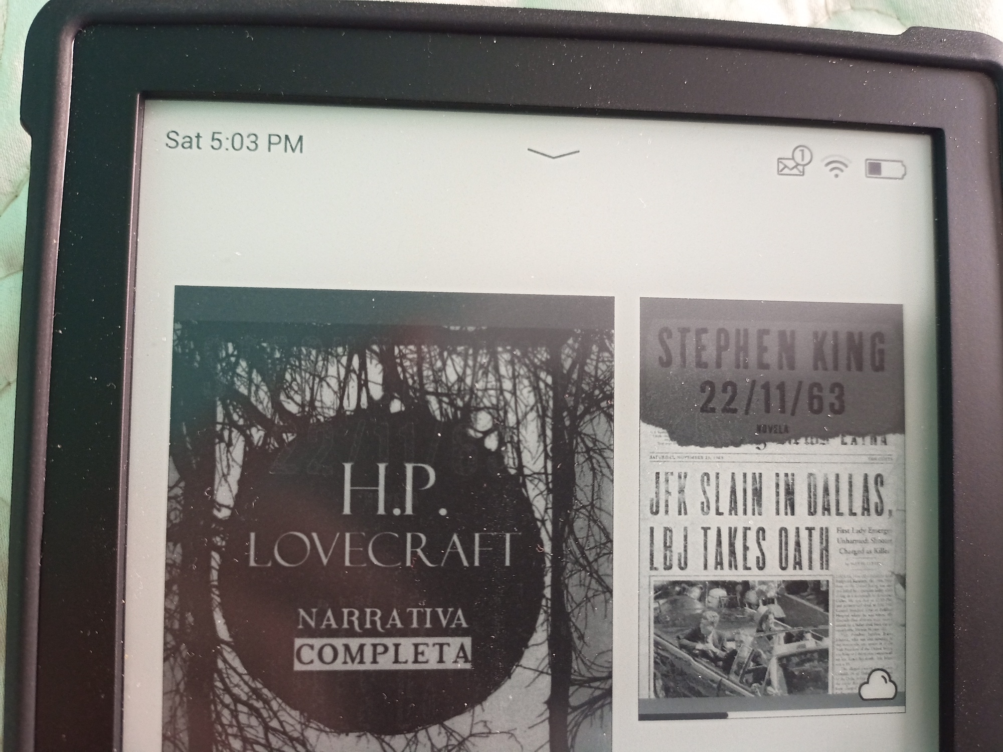

The device tells me I have 1 notification, which I don't see when looking at them, so I don't know how to remove that icon on the Taskbar above.

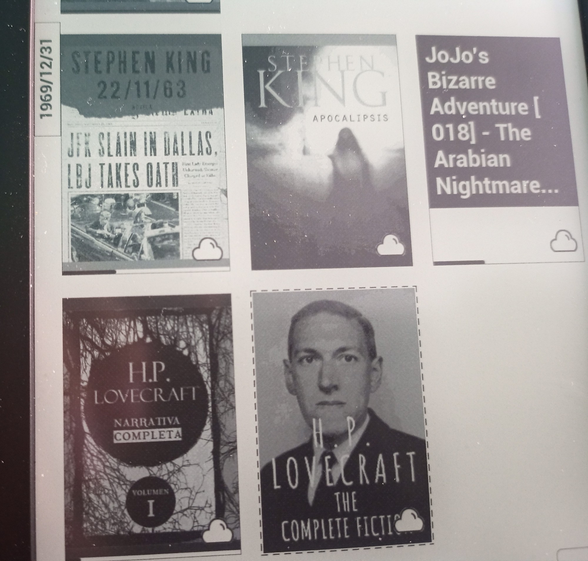

I'm using Calibre to load my books, the cover size is wierd, if I make the cover the same ratio as the reader screen, it looks great on the turned off screen, but on the menus there are some white or black bands to fill the image slot, and viceversa, if I make a cover a size to fit on the menus, the turned off screen has vertical white or black bands, I find that really annoying lol
I figured how to refresh covers displayed on the device by erasing the cache, but some covers don't show up at all? I can see the covers when I'm using Pocketbook on my phone, but they don't show on the device that's wierd.
If the 6.x firmware is like the 5.x firmware, you just go to the notification panel (by pressing the double horizontal line on your "home" screen — the bottom line is shorter than the top). Then just press the 'X' to close whatever it that is they're notifying you about. In my case it was setting up Read Rate and Dropbox (which I didn't want to do). It will also notify you if you need to set up sync, etc. Once you close the notification (by pressing the 'X') it shouldn't come back (unless you Send-To-PocketBook and you have a book waiting or something along those lines which will produce a new notification).

I don't see any notification to press X, so I don't know how to remove it

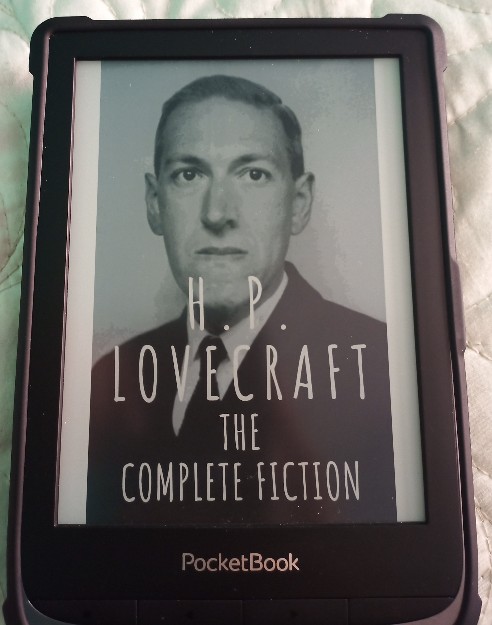

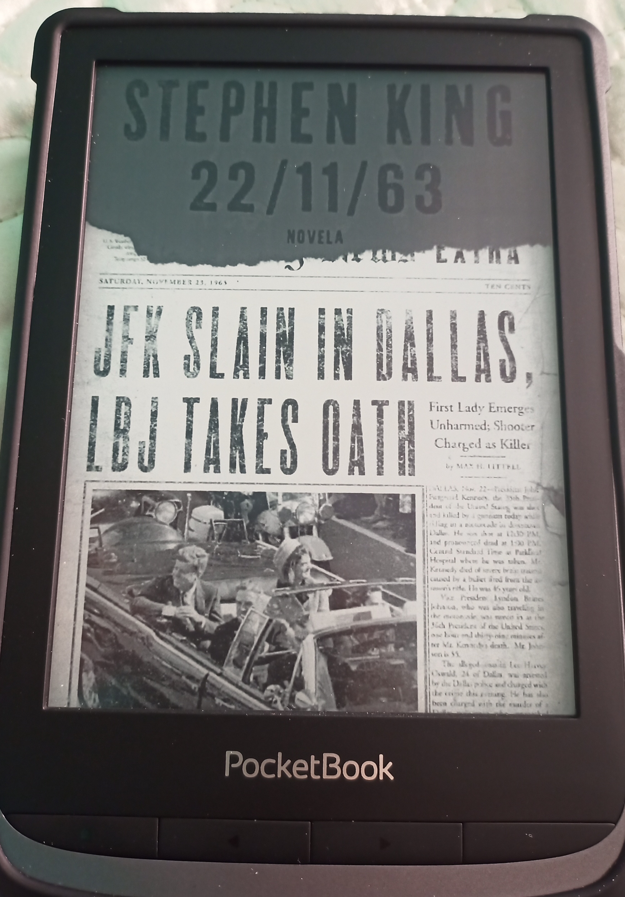

These are the bands I'm talking about, as you can see, the HPL book looks good on the library, but not on the turned off cover, and viceversa with the King book

"I figured how to refresh covers displayed on the device by erasing the cache, but some covers don't show up at all? I can see the covers when I'm using Pocketbook on my phone, but they don't show on the device that's wierd."
I had the same problem with my PocketBook Color. It turned out that the root cause was that the title of the book had a ' in the file name, like in "don't" or "Peter's" so try to remove unusual characters from the file names of those covers that don´t show up.
I also found that some generated covers of .cbr and .cbz files were duplicated so two different books got the same cover. However, after several days of use after I removed the strange characters in the file names, all the book covers became correct.

Definitely trying that, thanks for the info. To erase the cache I looked for t HB e sustem folder and simply erased all the cache folders inside it.
I just updated to the new version, the 1 Notification is still there, it's annoying af...
