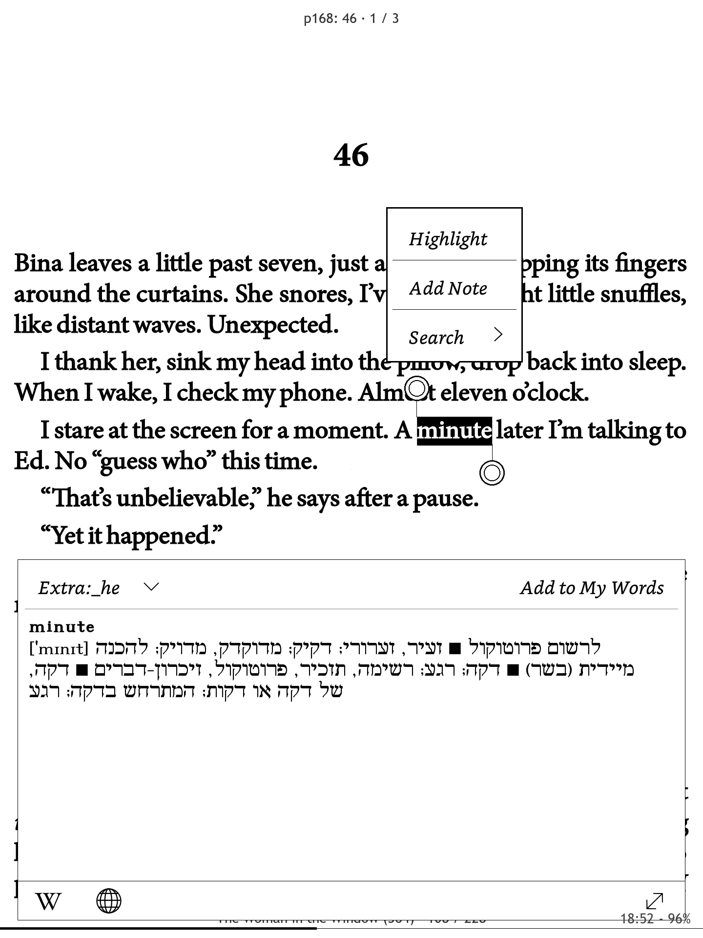

Originally Posted by Ntress View Post
I tried changing it to Code2000 in the lib file after jackie told about it, still didn't work out.
I don't read any Hebrew but assuming the attached screencap looks OK, it all seems to be working fine for me using the font and dictionary you linked to, installed as an "Extra" dictionary following the documented custom dictionary rules.
The font filename needs to be Code2000.ttf to match the internal fontname. Then reboot after sideloading.
The kobopatch Dictionary text font-family/font-size/line-height needs to match the internal fontname exactly:
      Find:    "Georgia "
      Replace: "Code2000"
      MustMatchLength: yes
Additionally enable this patch Allow searches on Extra dictionaries in libnickel.so.1.0.0.yaml
The dictionary filename needs to be dicthtml-he.zip
You need to make sure that he is included as one of the languages in the ExtraLocales line in your config file .kobo/Kobo eReader.conf, e.g.
ExtraLocales=ch, cl, co, d2, he, mw, oa, oe, wb, wk, wu
      Find:    "Georgia "
      Replace: "Code2000"
Thank you for the effort.
Well, I did all of this steps, the ExtraLocales line was not even exist in my KoboeReader.conf so I added it.
I see the added dictionary but I still see those characters instead of Hebrew.
I still cannot choose the Code2000 font from the [Aa] menu.
Maybe it's something with the font I have, could you upload yours?
I used the Code2000.ttf file from your link (renamed to match the internal fontname). If you can't see Code2000 in your [Aa] font list then it's never going to work in the dictionary. That's the problem you need to fix.
The only thing I can suggest is to delete your copy of Code2000.ttf from the /fonts directory then reboot to make sure that it's fully uninstalled.
Then copy it back again to the /fonts directory and reboot to make sure it's fully reinstalled.
If that doesn't work then try sideloading a different free font which supports Hebrew and adjust kobopatch accordingly. The font's internal fontname, external fontname and the patch MUST match exactly.
After that, I'm out of ideas. You can see what your linked Code2000 and dictionary files look like on my Forma. If that screencap looks correct then the problem is something you're doing (or not doing) and not successfully communicating in your posts.
