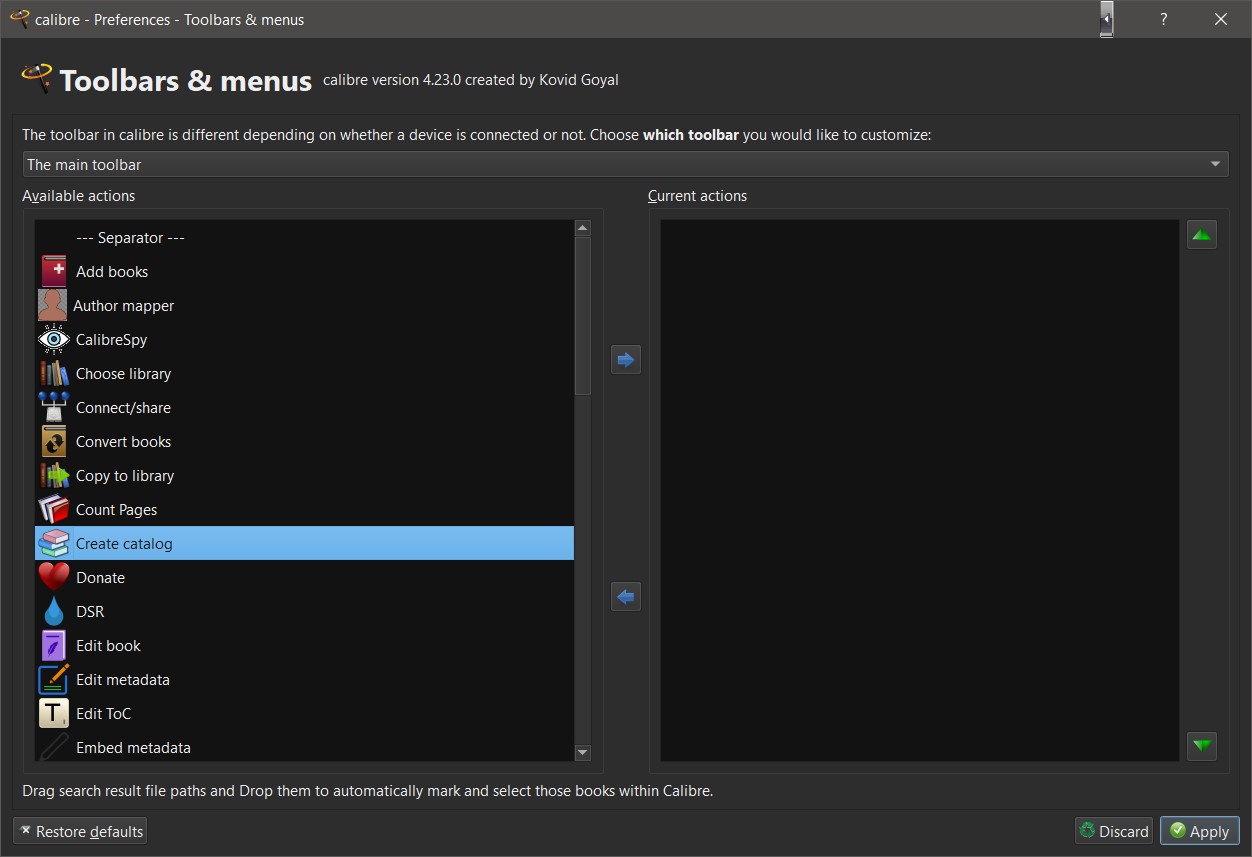

the "Create catalogue" tool is available as a discrete item that can be added to any toolbar or menu in the normal way
Name:	Annotation 2020-09-09 091250.jpg
