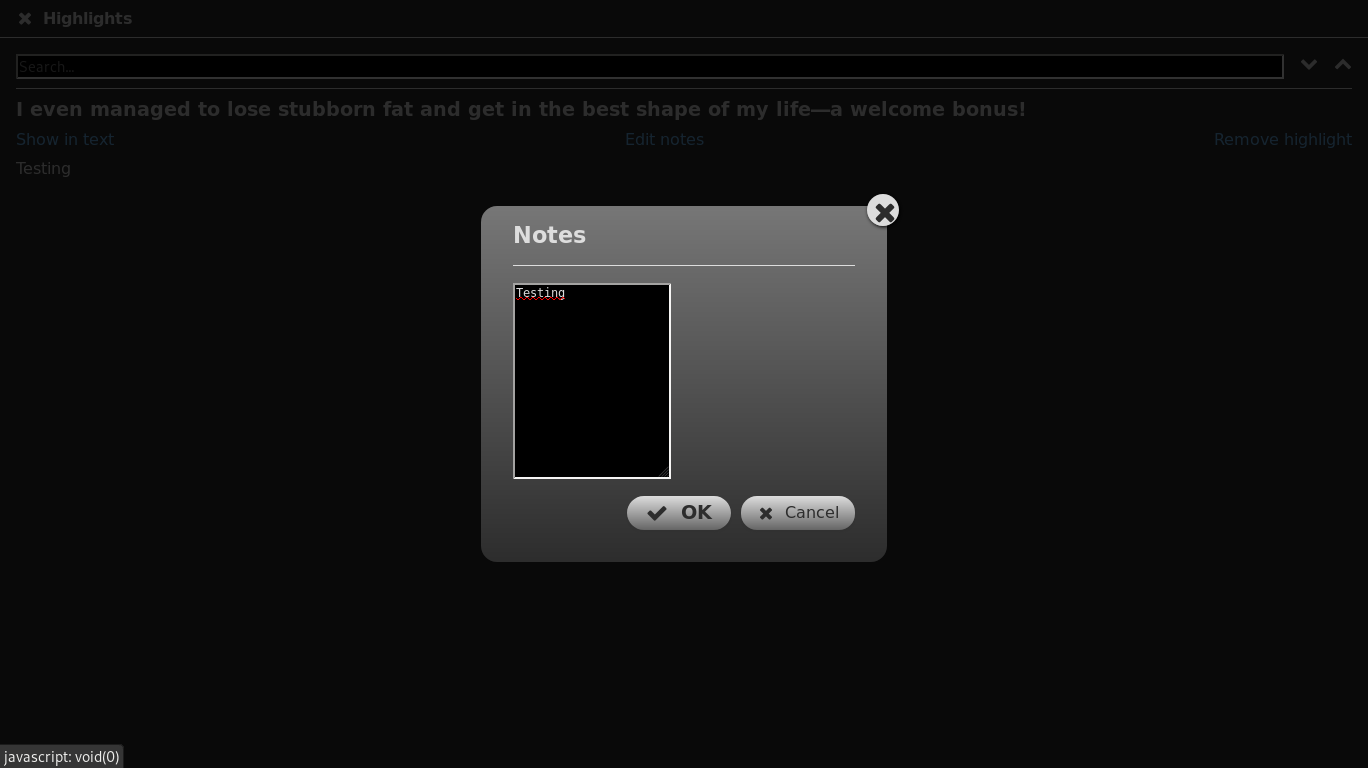

The field for editing the notes from the Highlight panel is just half the width of the popup window in Firefox.
Name:	Skärmbild från 2020-08-20 20-40-16.png
