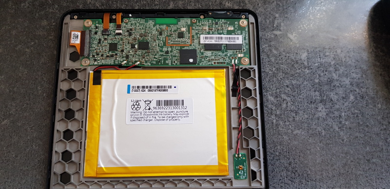

the battery is not easy to change, it is glued and the two cables are soldered, but maybe the biggest problem is finding a compatible battery maybe on aliexpress.
attached photo Libra.

The photo gives no information on what battery to look for. That makes it less then useful.

Perhaps the info might be on the backside of that battery?

Unlike the Kindle Keyboard, it's just a naked cell, no internal controller. The Kindle DXG and Kindle Keyboard need a specific cell pack.
The battery controller for the Libra is on the main board, like some Android tablets, so all that matters is that the replacement LiPoly is the same physical size. It's soldered. Some clear nail varnish after re-soldering will stop the joints corroding.
