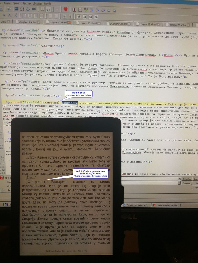

I have KoboAuraOne and while reading KePub file I noticed that Kobo, sometime, add spaces between letters, of the first word in a line. Example will be on book in my language, so please forgive if you don't understand text. But visually it will be clear.

In the background is Sigil with opened "problematic" ePub. Problematic word is:
Фиренца.
In Sigil (ePub) there are no spaces.
Problematic line in KePub file also don't have spaces, and code look like this:
<p class="normalweb1"><span class="koboSpan" id="kobo.109.1">„Фиренца. </span><span class="koboSpan" id="kobo.109.2">Банкарски кланови су његови доброчинитељи. </span>...
But on Kobo, opened KePub file, there are spaces (like on picture above).
This is not the only word. It happens on every second page.
Is it problem with how Kobo "read" KePub and is there are any solution?
I copied original ePub on KoboAuraOne, and it doesn't have problem with spaces between letters (same settings, except ePub does not support adding weight on added fonts):
<a href="https://ibb.co/yR9yQ08"><img src="https://i.ibb.co/yR9yQ08/problem-blanko-znaka-e-Pub.jpg" alt="problem-blanko-znaka-e-Pub" border="0"></a>
Kindle Voyage don't have this problem, no matter the font or size.

It's because Kobo is attempting to justify the text and not doing a good job if it.
I don't know it is in your language (Russian?), but in English Kobo has bad hyphenation settings. When justifying text it will not split words lie it should so you wind up with weord spacing sometimes.

No, it is exactly that. Since Kobo is attempting to justify the text and hyphenation is turned off, it has to insert spaces in sentences and sometimes words to keep the text justified.
Originally Posted by rashomon View Post
I just checked all setting in patch, and I enabled "Set KePub hyphenation". But hyphenation is not enabled in KePub file.
The problem there is Kobo's default hyphenation settings are ridiculous and so Kobo rarely ever hyphenates words.
Try installing the better hyphenation dictionary here. It should help a lot.
All of my experience has been in English. Not sure if they apply to displaying your language.

Have you tried to set letter-spacing to normal or zero?
Without hyphenation you gotta have holes somewhere.
