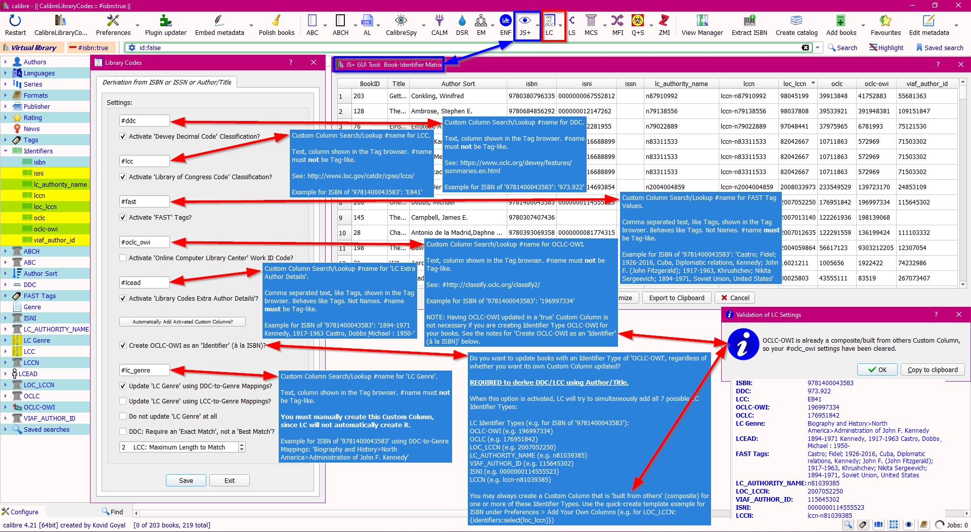

Proper Custom Column Configuration
Originally Posted by shayaknyc View Post
I didn't manually recreate the columns, I used the LC plugin to automatically create the new columns.

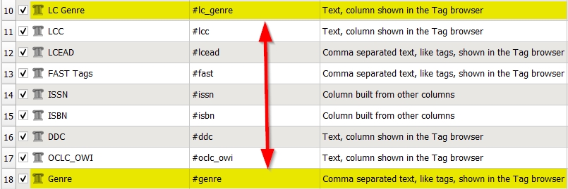

Not for LC Genre. See the attached images for their ToolTips and their correct types.
LCGenre has a 1:1 mapping of book:LCGenre, unlike normal Tags and Tag-Like columns which have a 1:many relationship.
You need to change your #genre to #lcgenre and let LC automatically create it. Your #genre, being Tag-Like, is not for use in Library Codes.
Added: Worldcat has changed their site, so I have a lot of work to do to get back to where LC was before the changes. Don't hold your breath. In the meantime, if you want what you are not getting, you will have to add it manually.

Ok, I now have 2 columns:
1) Genre, #genre, Comma separated text, like tags
2) LC Genre, #lc_genre, Text, column shown in Tag browser
(Screenshot: https://snipboard.io/Tgp5aF.jpg)
And here's the screenshot of the LC config after i clicked on "automatically add..." button:
https://snipboard.io/PoemZa.jpg
Here's the output after I selected Abaddon's Gate and clicked on the LC button:

Here's a screenshot of the Abaddon's Gate record:
https://snipboard.io/8ZLxJD.jpg
Now, DDC is null, LCC is null. You'll notice that #lcead has an entry, as does #oclc. Honestly, not sure what's changed?

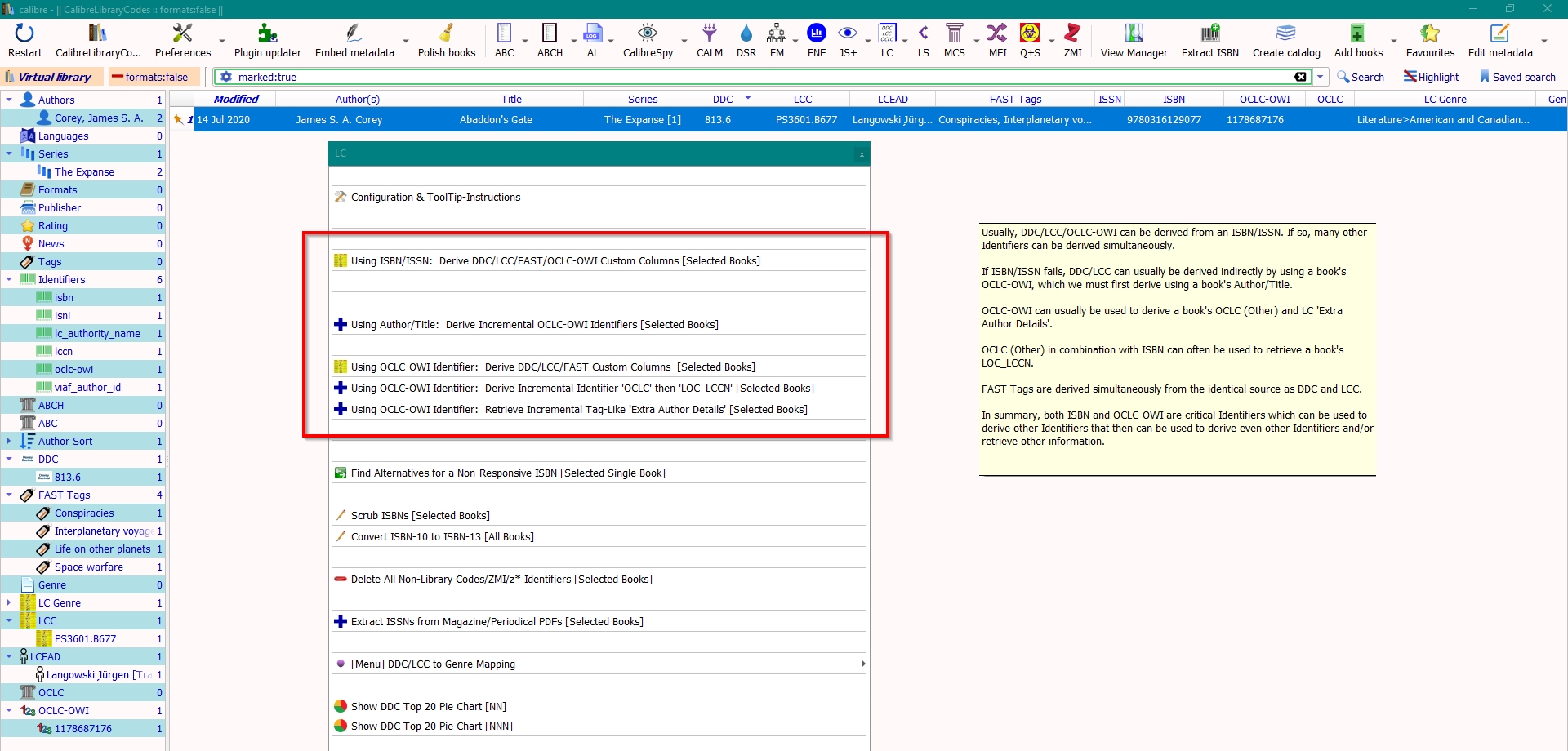

Use the LC Menu
Clearly you are not using LC properly. I suspect that you just click the toolbar icon button, and then complain that you have problems. The real problem is that you are not using the LC Menu.
When I personally use the LC Menu for the Expanse book that you have been testing, I get almost everything in LC. Worldcat is still broken, so I don't get OCLC (the other one, not OCLC-OWI), but that is highly optional anyway.
See the attached image. Read the tool-tips. Use the menu. All of it.

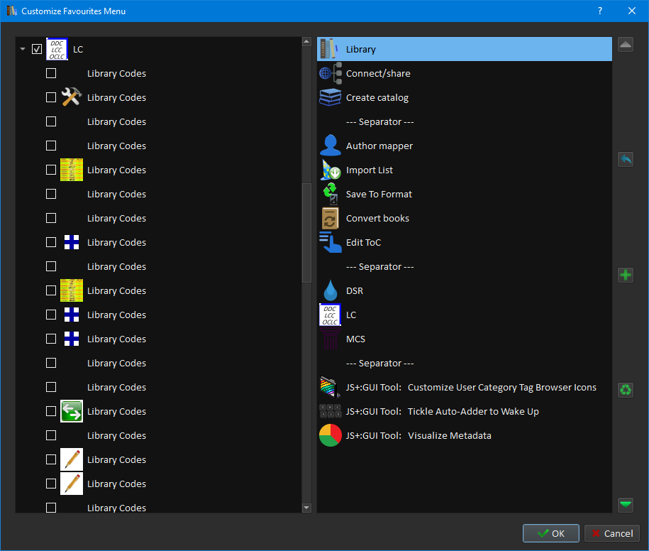

I found an unusual interaction between this plugin and the Favourites Menu plugin:
Name:	2020-07-16 20_38_50-Customize Favourites Menu.png
Other plugins (including both Job Spy and MCS) do have their submenus appear correctly, so I'm not sure why Library Codes doesn't. Thankfully I can rename the entries but they're a little bit hard to tell apart when adding them in the first place and it seemed weird enough to report as possible bug.
EDIT: Ok more odd behaviour: I added "Convert ISBN-10..." to the Favourites menu and renamed it. Its icon vanished from the menu and it doesn't actually activate. It's not a big issue because I can use it from the LC menu anyways but it's still strange considering the JS entries work.

Qt blank menu lines
Qt blank menu lines show up that way for all plugins that use Qt blank menu lines.
All GUI plugins use the identical Favourites-plugin compatibility code originally written by kiwidude when he wrote the Favourites plugin years ago.
DaltonST

I noticed the blank line thing for the JS and MCS submenus. It just seemed strange that LC did that for all its menus. Maybe it's just gremlins again.

Version 1.0.45 Major webscraping rewrites due to Worldcat site changes
Version 1.0.45 - 2020-07-17 Major webscraping rewrites due to Worldcat site changes. Configuration Dialog greatly enhanced for both validation of user settings and ToolTips. Minimum Calibre Version remains 4.6. BeautifulSoup 3 support removed.
Tested in Calibre 5 Beta 4.99.7 and required no changes.
See the attached new documentation. Note the ToolTip changes in Configuration.
DaltonST

When I get metadata for LC Extra Authors it seems to also download FAST Tags into both the FAST Tag column AND the LC Extra Author column. I don't remember that happening when I first downloaded the plugin. Did I enable that in the options somewhere?
