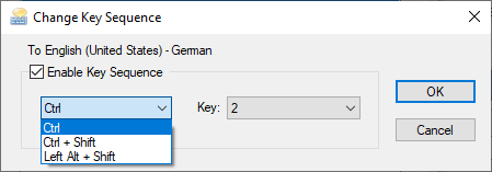

Old 07-10-2020, 09:41 AM   #7
Doitsu
Doitsu's Avatar
Posts: 5,819
Karma: 24222221
Device: Kindle PW2
What "Language bar"?
Advanced Keyboard Settings > Language Bar Options > Advanced Key Settings > Change Key Sequence. (See screen capture.)
BTW, I wasn't able to reproduce this issue.
@rashomon
1. Does this also happen when you use Left Alt + Shift without a number to cycle between languages?
1. Have you also assigned Left Alt + Shift + 2 to a Sigil option?

Yes, I'm talking about Windows Language bar (Input language hot key). Current settings:
https://ibb.co/cvvWcZs
I just switched from Sigil 0.7x, where did not have any problems.
I did not set any additional shortcut in Sigil.
What is „QtKey”, and where is setting for it?
Problem appears even when i don't have any ePub open. Just start Sigili, press ALT + SHIFT + 2 and it blokcs.
