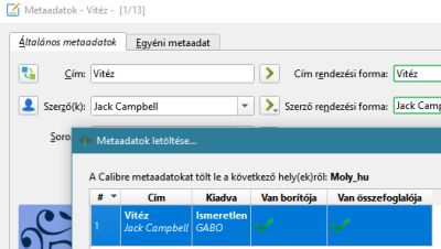

Originally Posted by Azurea View Post
Hello Guys,
Your plugin completely stopped working since the last update. I've check with couple of books and the result was always same.
Can you please check the attached file about the output?
Thanks and Regards
Hi,
It works for me.
ID:	180401   Click image for larger version
snowdog is offline   Reply With Quote
Hello Guys,
Thanks and Regards
Now I see you used an older version (Moly_hu (1, 0, 4)). Install the latest version Moly_hu (1, 1, 4)!
This is in the log file you sent:
****************************** Moly_hu (1, 0, 4) ******************************
Found 0 results
Downloading from Moly_hu took 0.867000102997
Title:Vitéz
Authors:[u'Jack Campbell']
