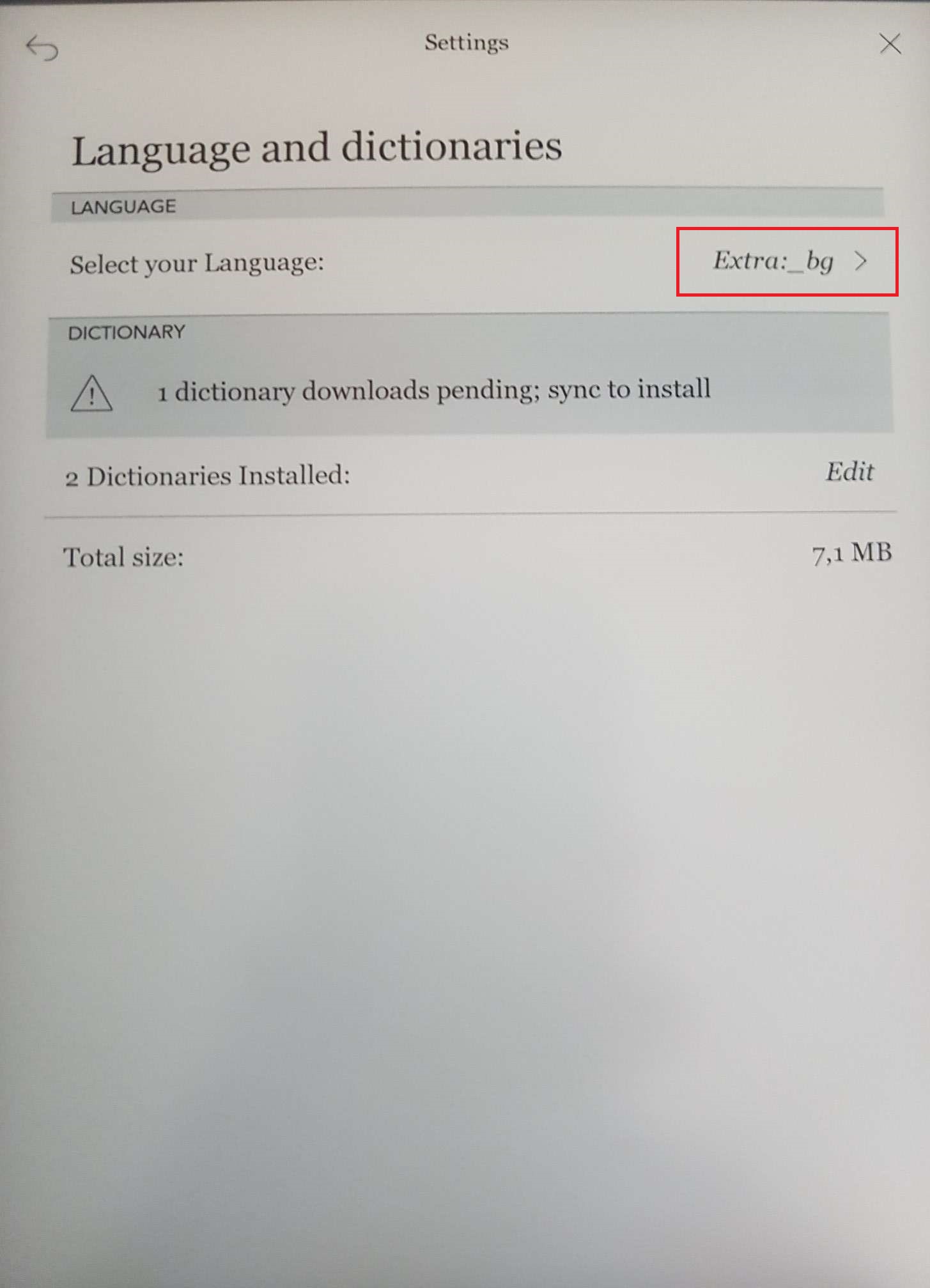

Any solution in this situation?
When one of the built-in languages is selected, for example English - all is OK.
