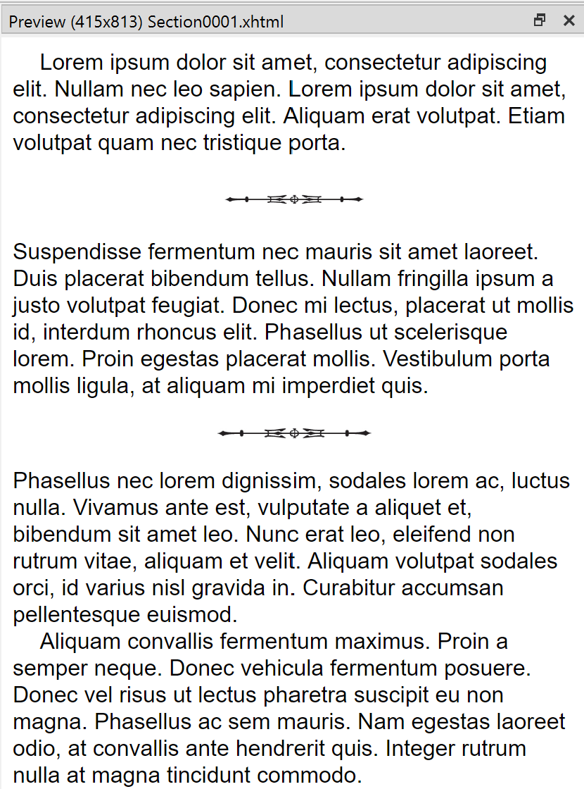

I think what the accessibility group was getting at, was that software can be programmed to recognize an <hr/> and treat it differently than the <p> or <div>. Visually it doesn't make a difference, but the standards that support accessibility should be followed.
Using their 2nd example, I was able to include images, or fleurons, within the <hr/>. It actually became easier/shorter to code as well.
I previously used this when inserting a scene break:
<div class="ChDiv"><img alt="" src="../Images/fleur.gif"/></div>
Now I can use:
<hr class="ChDiv"/>
and the CSS for <hr> is fairly straight forward:
hr.ChDiv {
  border:none;
  margin:1.25em auto; height:.5em;
  background: transparent url("../Images/fleur.gif") no-repeat center;
  background-size: auto 100%;
  overflow: hidden;
  page-break-inside: avoid;

Dion, dear, since I'm a lazy very busy old thing revered elder??, can you slap the sample ePUB/MOBI in here? That contains that test code?
Hitch
Sure thing!
The first fleuron is using my <div> method, the second is using the <hr>.

Sure thing!
Thanks, bud.
I'll take a look. We try--we do--to address usability and all that, but sometimes, they kinda make me want to scream. I mean...we have a book in with 654 images. (sigh). And of course, the author didn't put in title or meta info!
