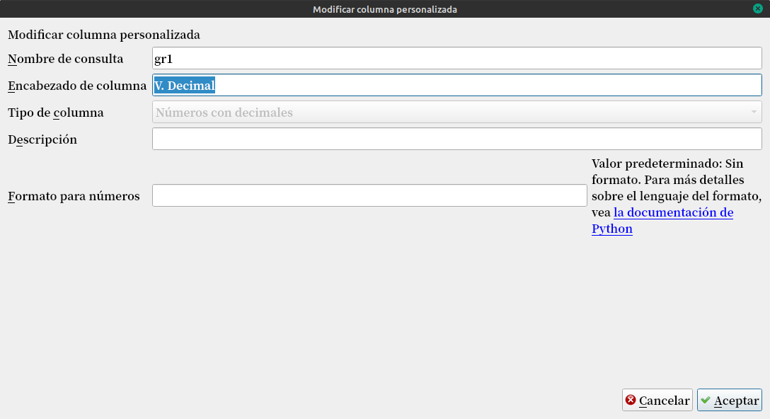

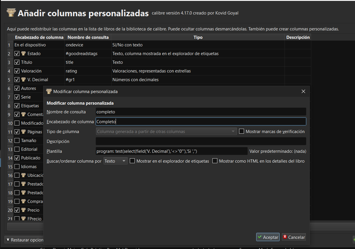

I have a custom column with decimal numbers for the book grade.
I would like to make a column that depends on it to tell me if all the data in the book is complete, if the decimal column has the column heading "V. Decimal" and the query name # gr1.
What should the template be like?
I tried with program: test (select (field ('V. Decimal'), '<> "0"'), 'Yes', '')

I'm not sure what you are doing. But, I can see some errors.
Firstly, you don't refer to a column by the column heading. You need the lookup name. For a custom column, this will always start with a "#".
Then, "select" only works on identifier type columns. That means the value you are checking needs to have a ":" in it. Unless you are formatting the decimal with a colon instead of a dot, which I don't know how to do Or is the column a string that just happens to have a number?
And the second parameter of "select" is the id name. So, basically what is to the left of the colon.
If the column is actually a number, then the following might work (with your column's lookup name):
program:
raw_field(list_item(field('#mm_progress'),1,'.'),0,'','Yes','')
Which I really don't like. Because I am treating the number as a list using a dot as the separator, taking the second element and then comparing it to zero. It seems to work, but I don't like it.

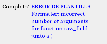

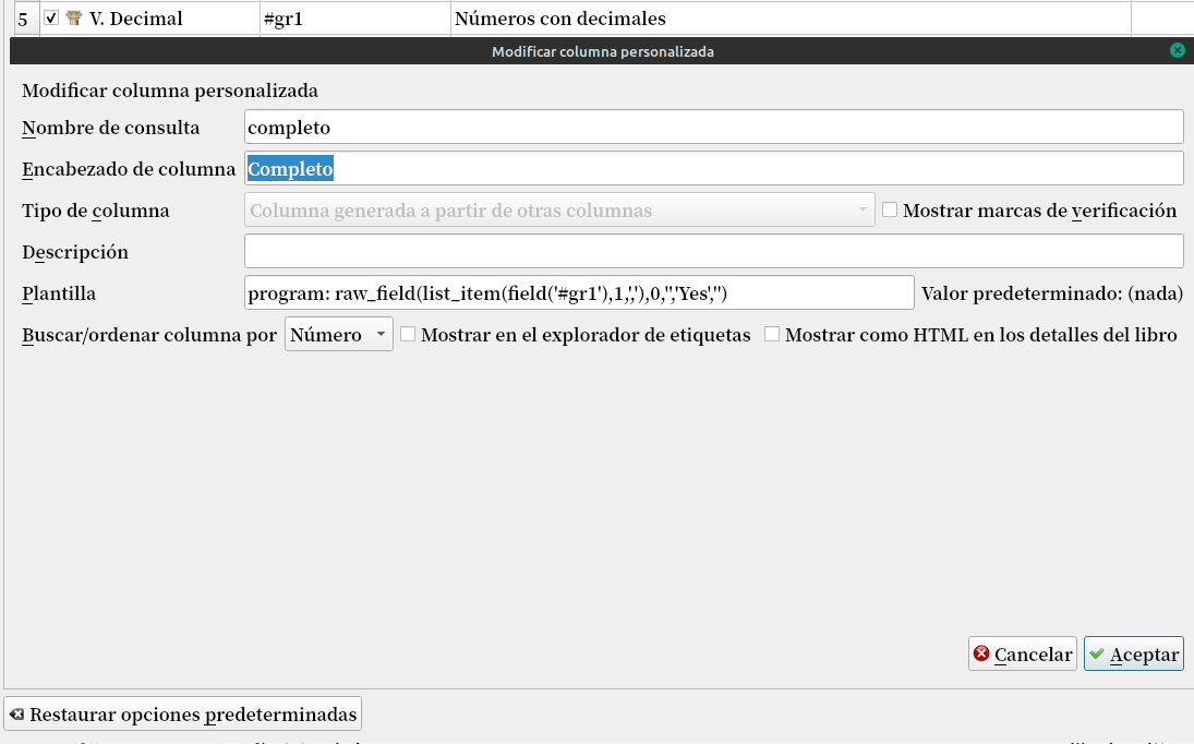

The column has a decimal number separated by ","
I have made replacements to his formula with my names and he doesn't seem to like it.
program:
raw_field (list_item (field ('# gr1'), 1, ','), 0, '', 'Yes', '')

I assume the comma is a locale thing. But, there shouldn't be a space after the "#".
If that isn't it, is there an error message?

Hello Davidfor The space appeared in the message when writing the code, in calibre it is not.
I leave screenshot with the error it gives.
Thank you !!

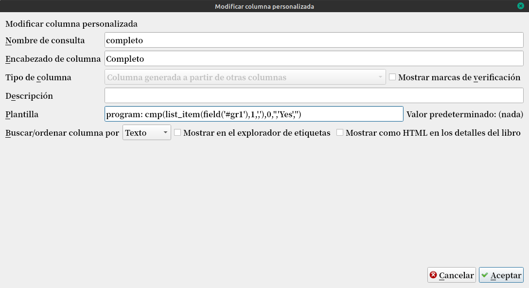

Sorry, that was my mistake. What posted before was wrong. The first function should be "cmp", not "raw_field". I have no idea how I did that.
It should have been:
program:
cmp(list_item(field('#gr1'),1,','),0,'','Yes','')
The alternative is:
program:
cmp(list_item(raw_field('#gr1'),1,','),0,'','Yes','')
The possible advantage of that is that the value of #gr1 doesn't go through any formatting specified for the column. Though I don't know if the decimal point will be locale specific, so it could be a comma or a dot.

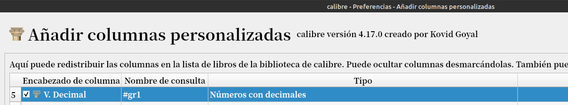

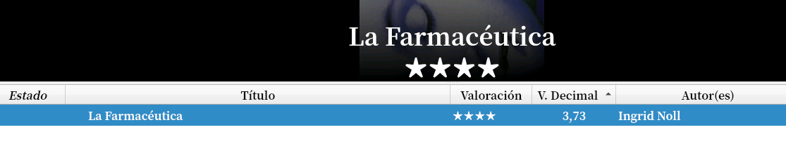

We are close the two codes work half, let's say
I don't know why because the "V. Decimal" column has no format or code. I leave catches.
If the column has a value it is ok to put yes.
And it is expected that if it is empty it will put No but yes.
I don't want to be annoying, if you can't. I forget about those settings. Thank you very much for your time and for the prompt responses.

My quick and dirty cheat is to return a value that triggers the appropriate response if the column is empty.
program:
cmp(list_item(ifempty(field('#gr1'),'0,1'),1,','),0,'','Yes','');
That should work assuming I changed from my test version to yours properly.

Yes now!!!! Genius thank you very much !!!
