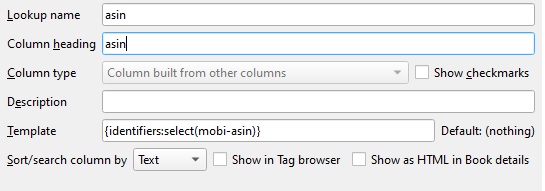

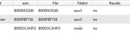

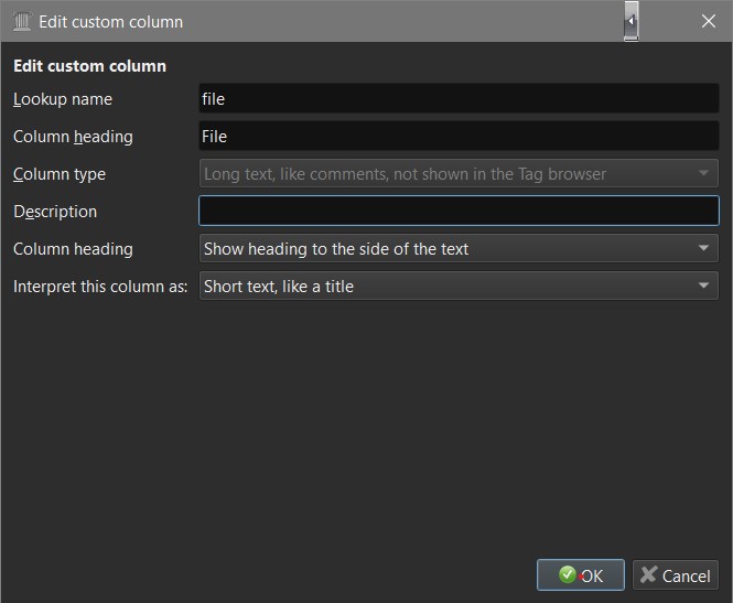

Thank you for your help. The equation works but isn't returning accurate results. Even though the asin and file name match its returning na NA should only come up if one or both fields are empty.
I've attached snapshots Im not sure why this is so difficult

Old 05-16-2020, 09:45 PM   #860
Posts: 22,920
Karma: 34252880
Try changing 'file' to:
