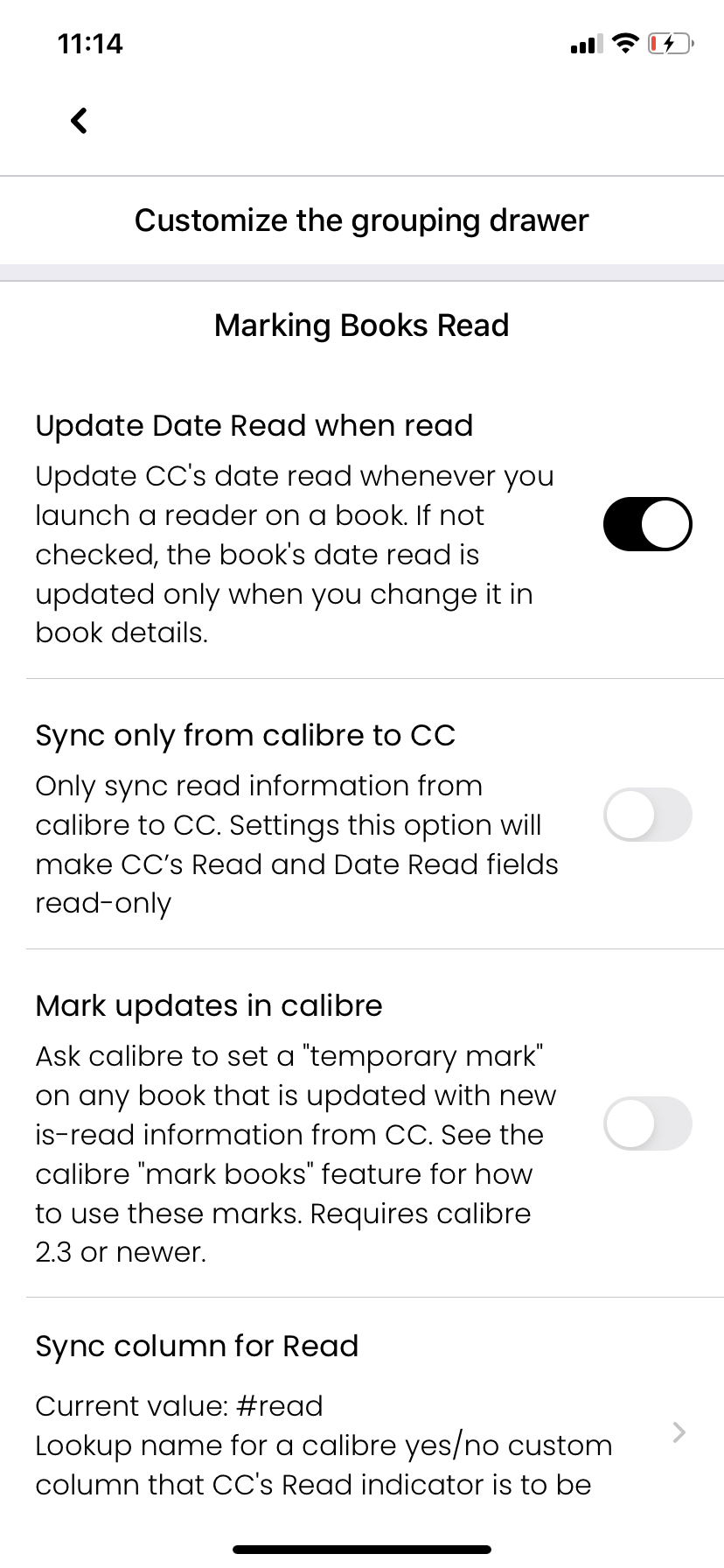

Hey,
I am currently testing this and my functionality is updating the book in my CC library to Read = Yes when I open in a reader (Books / Kindle App).
Do you have this setting set to enabled?
Not sure if my screenshot is attached but go to settings > Marking Books Read (Section) > Update Date Read when read

Originally Posted by PMrev View Post
Hey,
I did check my settings and yes I do have that option selected. I haven't made any settings changes since I initially set CC up. I have the #read column sync setting set up, but have never had the date read column set up as that's not a column I need.
I have an iPad Air 2 on ios 13.4 if that helps.
