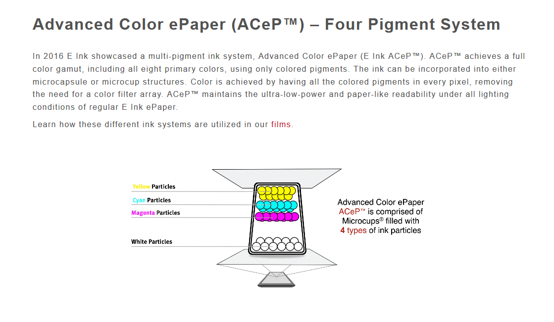

This is confusing... Are we sure, the information from GoodEReader is correct?
It kind of does not make a lot of sense, that Onyx would release a reader with an older CFA based color display technology, while Pocketbook and other chinese brands are using the newer, improved ACeP displays.
By the way, E-Ink has a nice overview of the different display technologies on their website:
-> https://www.eink.com/color-technology.html
-> https://www.eink.com/electronic-ink.html

c) Coloured balls in the milky white liquid. This has no dark shades unless there are also interspersed normal white & black shades.
The only way to have genuine higher mono resolution (for viewing rather than driving the filter) is an active transparent display of lower resolution that mysteriously works without a colour filter.
ANY colour filter layer on top of any monochrome display reduces the effective visual resolution to that of all the colour elements needed to produce white, so either 1/3rd on one axis, or 1/2 on both axis depending on how the colour is done.
If someone had invented a new display technology, we'd have heard about it ages ago. Some prove to be too expensive or too poor. Mirasol sounded good. Royalties, yield and poor colour compared to hype killed it. One eReader with two brandings for a Chinese and Korean booksellers.
There have been coloured eink for ages using the RGB filters. They need good lighting. I've seen red/black ones but it's not clear how those work. They are sold in small sizes for label applications. Probably labels are Advanced Color ePaper (ACeP) or "E Ink Spectra". I'd be surprised if that can be used to make an ereader.
Any colour ereader would use "E Ink Triton" (out for ages) or "Print Color ePaper- E Ink Kaleido", both of which are indeed the regular eink with a colour filter, just like LCD.
Poor saturation or else the panel needs too much front lighting. The Kaleido sounds like a printed plastic rather than glass filter but otherwise the same idea as Triton.
Tri= 3, so likely a 3 x 1 colour stripe, thus 300 dpi mono is a 100dpi x 300 dpi for mono or colour.
The "E ink Prism" isn't for displays.
