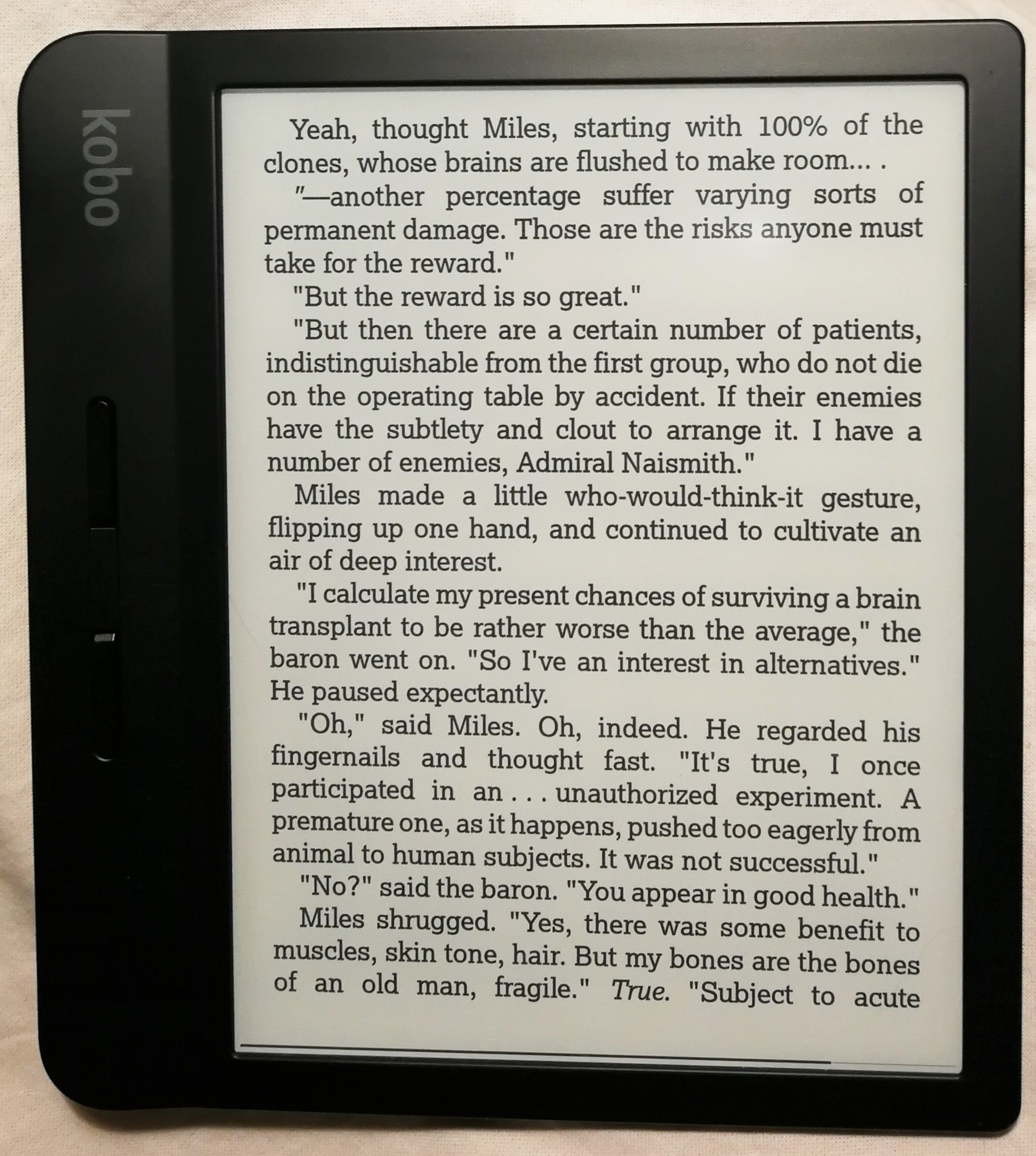

It's entirely possible to remove empty gaps by patching your Kobo (the patch about widows and orphans and the patch about bottom space). Epubs use Adobe page numbers, which you can display or not, as you wish.
Here is a sideloaded epub on my Kobo Libra (patched, page numbers are hidden by choice).
