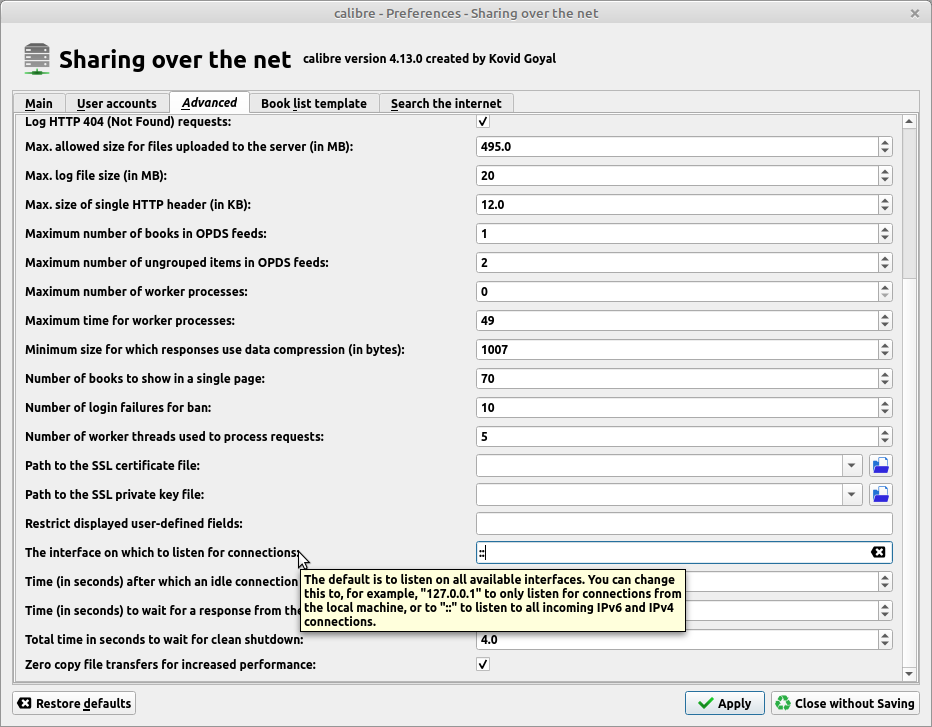

The port is already changed from the default 8080 to a random number i chose, and i can't sign in with the wrong password because the page i need to get to the password input won't load. I'm doing all this over wifi, but on the same network, so basically LAN, and all the computers I've tested DO have different subnets. (Like the server pc has 192.168.0.115 but the computer im trying to access it from is 192.168.0.117 which aren't my real IP addresses but still) Though i hadn't experienced any issues with this before now. I can access any folder i want if i set it shared, and lastly the antivirus I'm using is Avira, which doesn't seem to have any objections to calibre that i can see.

I mean i could grab the server log from the appdata folder but i'm not sure how to share it on here
Quick question is if it works without a password?

It works with or without a password on the host PC, but from any other it just times out before the library select page

Here you go. The very beginning of the log is about a year ago when i was initially learning about the content server and how to use it.
Go to preferences--sharing over the net click the Advanced tab:
go to "The interface on which to listen for connections" Clear it and enter ::
See screenshot:
Try--clear out your server logs first--then re-post if it works if not then post the new logs.
